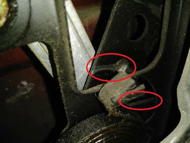

I've got a window regulator that needs repairing and that requires drilling a 1/8" hole into, and bolting together two flat pieces to "reconnect" them. I've broken 2 Titanium Nitride High Speed bits and can't even get a Cobalt bit to start. Thoughts or suggestions for a really bad ass bit that'll start and not break? Thanks.

On the window regulator, there are two flat pieces of steel (back to back) that are spot welded from the factory; the factory weld has broken so the window motor doesn't move the window while it's running.

The broken weld can be seen in this picture. The two pieces are supposed to overlap and move together; the one in the lower position is controlled by the motor and the upper one controls the up/down of the window.

For the amount of work you're going through to drill it (and I assume the goal is to then screw of bolt it) I'd really just ask around and find somebody w/ a welder. It's a 30 second job to do, and it more the right way to do it. I bet there's a half dozen guys here within a 30 minute drive that would do it for you. I sure would. It's doesn't even need to be a fancy or great weld.
Alternative: JB weld or similar.
