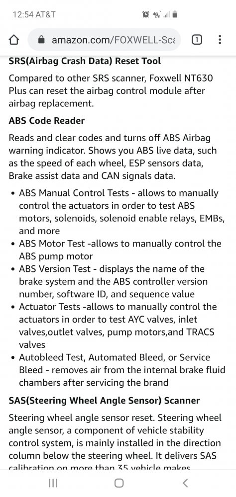

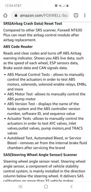

Amazon product ASIN B07CSMJJK9
Looks like this new upgrade doesnt like amazon links.. Here is the title and cost to look up on amazon.
FOXWELL NT630 Plus OBD2 Scanner ABS SRS Code Reader Automotive OBD II SRS Airbag Diagnostic and ABS Brake Bleed Scan Tool
$139.98 & FREE Shipping
Thanks! It looks like that one will do what I need.
