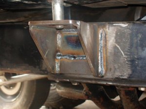

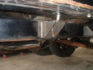

A friend did this and I thought he did a pretty darn good job . DSC03839.jpg
The actual frame mount looks very sturdy. I would probably think of revisiting the body mount/bolt. The mount/lift is very narrow and the bolt orientation is a bit crooked...possibly tweaking the body relative to the frame.
Best of luck.
Best of luck.
Thanks for the input , but the bolt just happens to be hanging out like that because its loose .
