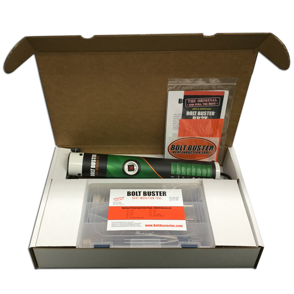

Anybody have any experience with one of them?? I toss a fair amount of stuff due to broken bolts that cant be retrieved.Mainly 205 adapters with broken shifter bolts and crossmember bushing bolts that are broken off at or near the edge of the adapter.The welded nut trick dont always work.Kinda pricey IMO but depending on the adapter it will only take 2-3 adapters to pay for itself.
I've got the sub $200 ching chong clone of this, use it on big trucks quite a bit. Does what a torch would do just better safer and quicker. Look on Amazon or AliExpress and get a cheap one, it's just an induction heater there's not much to it.
how many watt is it??
Really useful for getting the body bolts out of a JL or a Gladiator without breaking one.
Don't ask me how I know about this.
Ok this is cool. Never seen this before. I might have to get one when I get ready to pull the studs out of the old Ford 8n block for the intake/exhaust studs. Two are on their last leg and need replacing. One thing I love about this place is all the knowledge that gets shared.
Funny you made this post, I was just introduced to this induction heater thingy on the last episode of Fab Rats you tube channel. I had never seen one of these. being a "tool Junkie" I am curious myself
