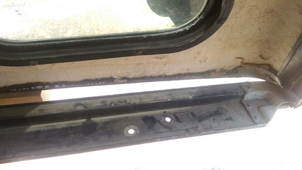

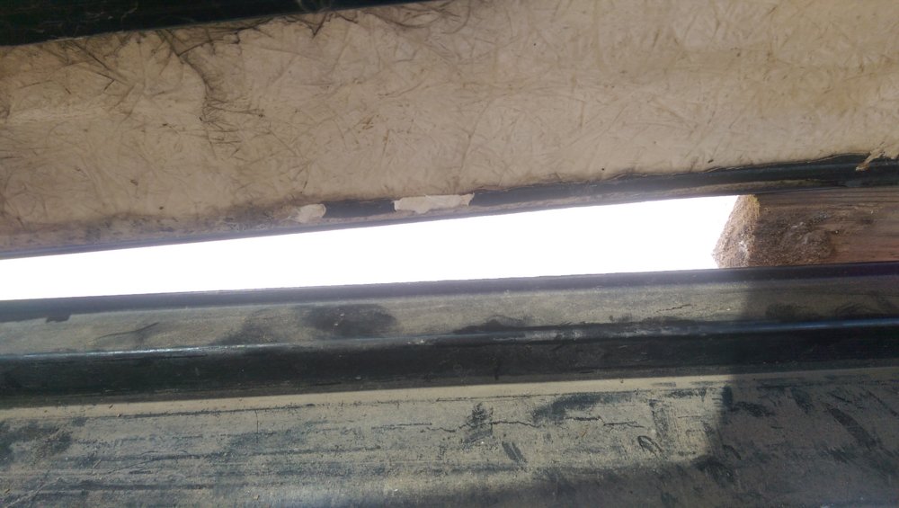

Pichurs:
That bondline looks like shit, no wonder that came apart. It looks like the adhesive took the black paint/finish with it, so the paint to metal bond was the actual failure. Looks like the adhesive wasn't applied in the right place, or at the right thickness, and wasn't clamped properly so there are a lot of voids because it never made good adhesive contact.
What feature of the aluminum extrusion was bonded to? I'm having a hard time figuring out what that profile looks like; the adhesive was in a recessed channel it looks like? That's good for bondline thickness control, so too much adhesive doesn't get squeezed out during clamping/fixturing. You can clamp tight to the aluminum, and still have a proper thickness of adhesive in that recessed channel. Same reason a lot of structural adhesives have glass beads of a certain diameter in them.
If you can get a 2 inch Roloc surface conditioning pad on a right-angle die grinder in there, you should be good to go.
Is that channel (where the adhesive is) really as small as it looks? What is the total height of the face of the extrusion, and what is the width of the channel?
You're going to need a few clamps, and something (wood, whatever) to use as a clamp bar to spread the clamp load across the full length of the joint to get the fiberglass in proper contact with the extrusion during cure.
As shitty as it sounds, if the cap is only 4 ft long you may consider redoing the entire perimeter properly. Unless this happened because of an impact on that one side, in which case the other side may not fail anytime soon...

The bond area is about 3/4" high. The recess is 1/4" high x about 1/16" deep.
The cap is 8ft long, but broke loose over about 6ft of the length. Only about 4ft of that is accessible, so that's the part I'm working on re-adhering. It came out of a junkyard, so likely failed due to an impact on that corner that deformed the bed.
Well, get to whatever you can with proper prep and adhesive, and run a bead of caulk or seam sealer over the entire rail after that to seal the part in the middle that you can't get to. Should be fine.
