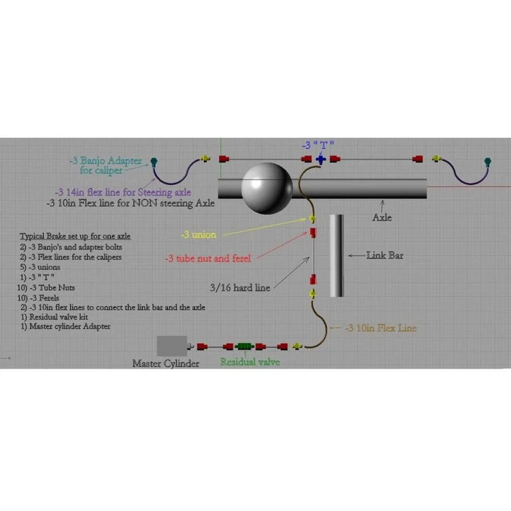

You could get -3 lines made up at a hose shop and run all flex for the fewest connections. I’m more worried about the hard to soft junctions on mine than anything. From wood, they sell kits with all the necessary fittings and soft lines, can use generic pre flared sections for the hard line from parts store
