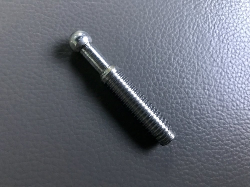

Does anyone know where to find a threaded ball stud (?) to use for a push rod? I've searched McMaster Carr as best I can but haven't come up with anything.

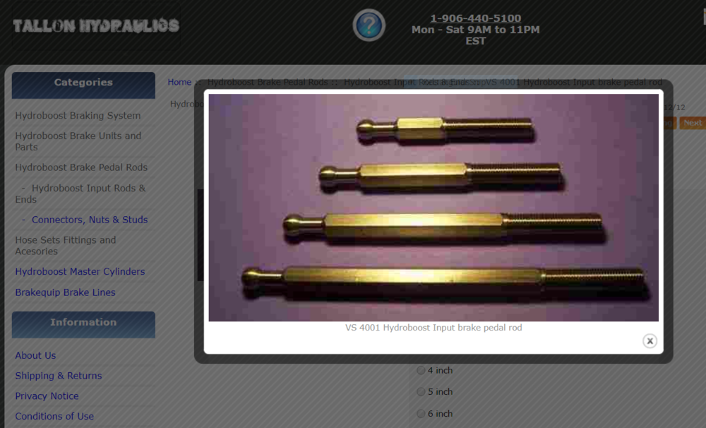

There is one company, Tallon Hydraulics, that carries exactly what I need, but I can't get in contact with them, and my google-fu found a post on another forum saying they couldn't get up with them either.

The universal kits won't work because they don't get short enough, I need roughly 2.5" from shank side of ball to center line of brake pedal mount.

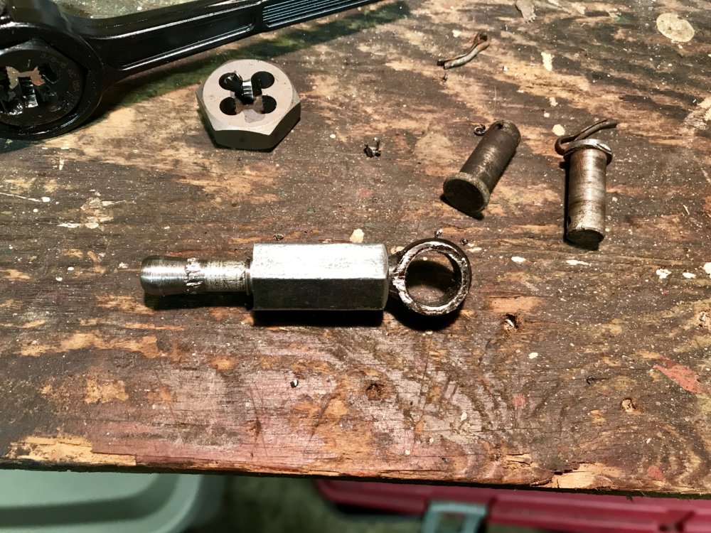

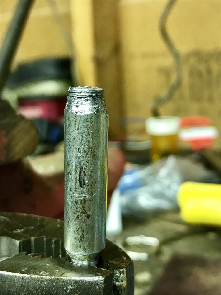

A) I can’t hold the pushrod I have strong enough to thread it with a die; it just spins in the vise I have and I’m scare I will ruin the ball. And,
B) I’ve already ruined one rod end from getting my die started at an odd angle and threading it crooked

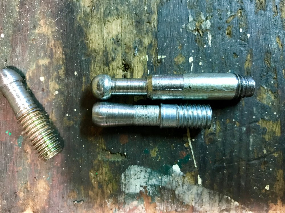

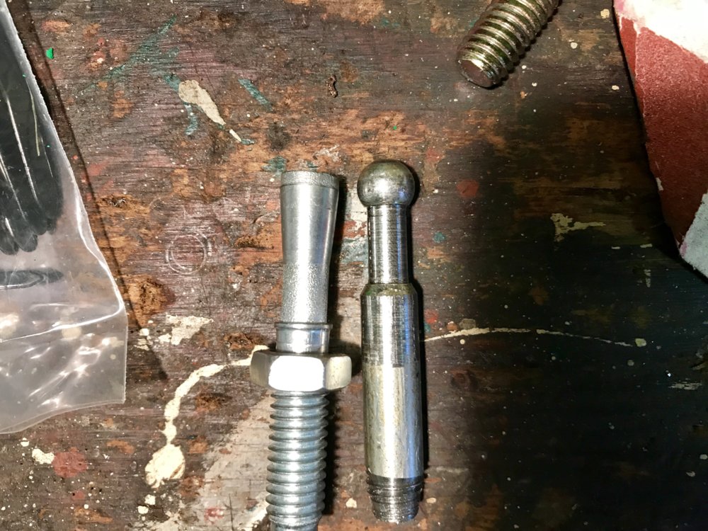

Off the shelf bolt, cut to length and the head rounded with a bench grinder?
Good idea! I might try that tomorrow. I wonder if there is a reason it's a ball to give it that hold in the pull direction?
Just weld an allen set screw of whatever thread size and pitch to your current ball stud

Welp. Gave up and took the original pushrod to Hamilton Machine and had it threaded in their lathe; I should have just done this a month ago.
My homemade ball end probably would have been fine, but I have a tendency to overthink things I’ve not done before.
