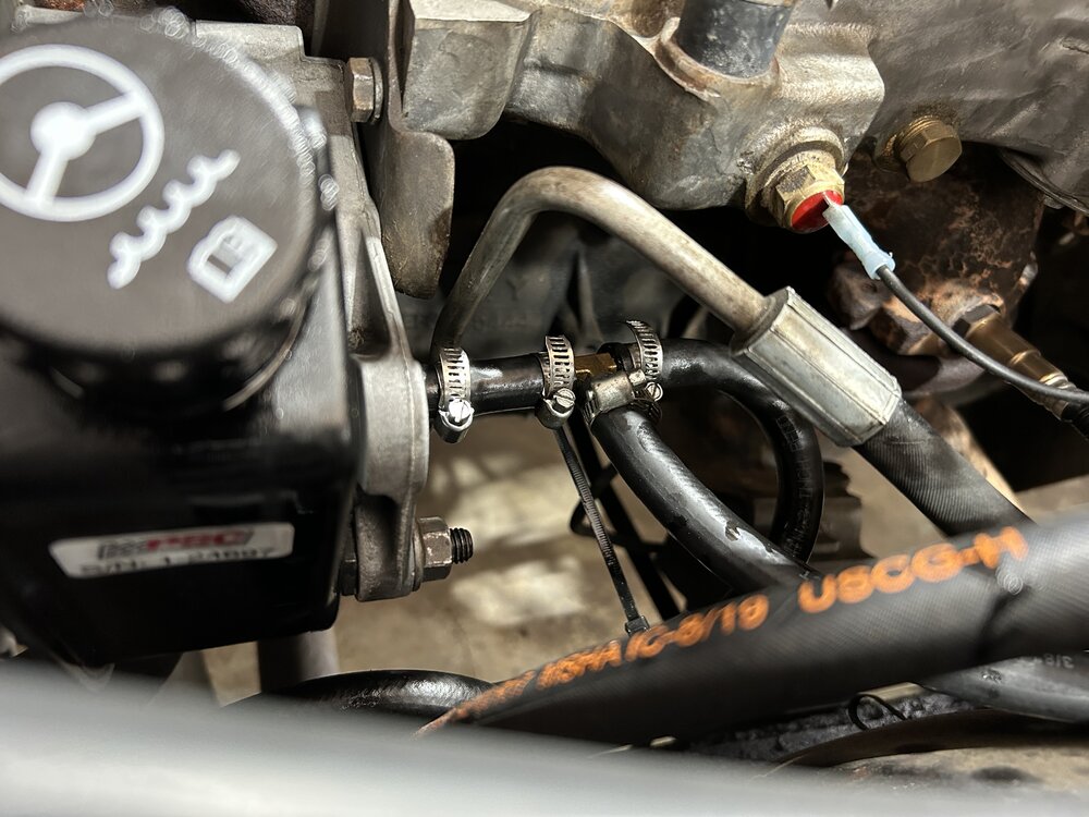

The cylinder on the hydroboost unit that the brake pedal attaches to isn’t returning to center all the way. I pulled it back with my hand and it fixed the issue.
Now I need to figure out why it isn’t returning on its own until it warms up.
Rerouted my return lines to see if that was the culprit.
I originally had the returns T’d together with the steering box and the booster on the straight and the leg headed to the pump. When I added the cooler I just took the leg going to the pump and plumbed it to the cooler, cooler to pump.
After doing some reading it sounds like in some instances the steering return can push against the booster return and cause problems when they’re plumbed straight on the T. I also installed a PSC pump late last year and am curious if that was exacerbating the issue.
So now I have the T right off the return port on the pump, the booster is plumbed to the leg and the steering is running through the cooler and to the straight.
The ‘correct’ way to do it is to have two return ports on the reservoir… whoops. Oh well.
