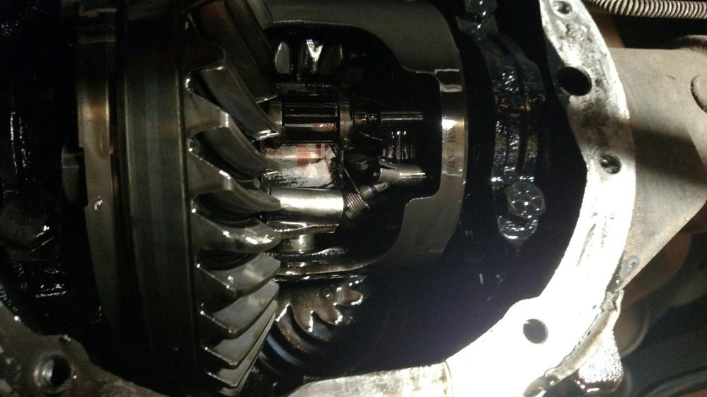

Looking for some ideas of what could be wrong with my rear axle. Rear axle is a 8.8, stock, Aussie locker. Driving home the other day on the road, every time I turned right there was a large pop/clunk and noticeable lurch. I would first think the R&P was bad, but going straight there was no problem, only when turning right. I haven't had time to pull the diff cover, so what do you think it could be?

I trailered it to the house and this is what I found.
Took out the ring and pinion and carrier with it. Ecgs had my parts here the day after ordering them.
I am hoping it is just pins and springs and that the R&P is OK, if not, then looks like I am going to replace the 4.10s with 4.88s
It's common the pins break. I don't even use the factory pins any more. I just cut a piece of 1/4" rod and use it instead.

I have driven the jeep a few times now and the sound and lurch have not happened again. Took the cover off and nothing seems to be wrong. Maybe just the locker failing to unlock quick enough??
