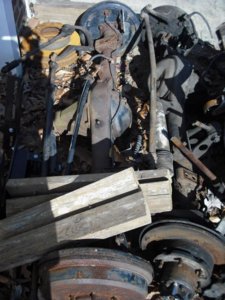

Forgot to add pic of the axles... Stock Toys, 4.10s
Need to find some Lunch Box lockers. Don't really want a spool/welded...

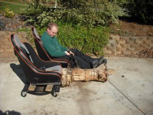

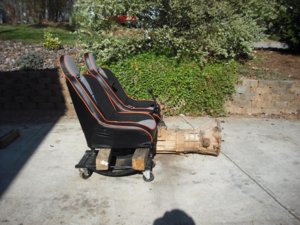

I have a ton of pics from last weekend, with the seats in various positions. Attempting to try some different configurations.
Right Hand driver w/ passenger seat in some different spots.
While it showed some advantages overall prolly not a good layout got general purpose rig... Sorta goal is for anyone to easily drive this with out needing to 'learn' anything.
Normal Left drive, with some various seat positions. high, low, forward, above t-case, rear of t-case, etc..
It all boils down to extra width vs extra height.
To which I won't know the answer until I do some full scale mock up with axles foe links etc. Regardless I'm still in the typical 48'-52" width range. Heights ~76" possibly less depending on seat lay back etc..

Lets call this the high/stagger seating.
It is higher on the list as it is still narrow(er) but allows for some elbow room.. Much of this BS will sort itself out when I can find an engine or at least a dummy block to better see how the exhaust & cooling systems might fall into place..

What advantage does the staggered seating give you? Narrower overall cabin width? Sounds like this will be a cool project to watch.

Basically when you slide 2 seats together, you tend to be knocking elbows with the passenger. You can either move the seats apart or yell at your passenger :)
In the driveway mockup session, even a 6" stagger allowed for a lot more elbow room.
It also will allow for space to be used for..... fuel/bat/??? dono yet..

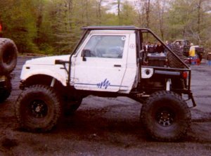

Here is a pic of my old zuke based buggy that Rich is referring to. Sami drivetrain, toy axles, 35" MTRs, leaf/leaf very light...
While not probably worthy by todays buggy standards I learned a lot building it that I've carried into every project since. Buy me a :beer: and I can tell you all about the pros/cons of doing a project like that one..
