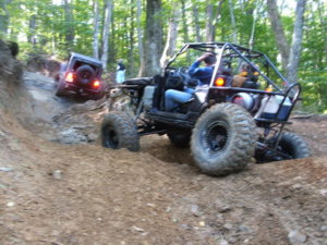

Sounds Like Brad Headricks (Atomic City) "Termite"... granted it looks like a chopped Sami, but seems to be more for appearance...
Don't quote me on the specs, cause I don't know rice...
1.6Swift mill on propane
Locked/alloyed Toy steering axles at each end
Lot's of other frufru... It works VERY well from what I've seen.
