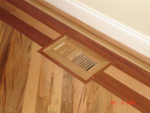

Also, have at least 9' ceilings and solid wood trim work, not the pressed paper stuff. Recessed lighting with dimmer switches are a nice inexpensive feature.
Hardwood floors throughout, except in bath/laundry. Go tile there.
