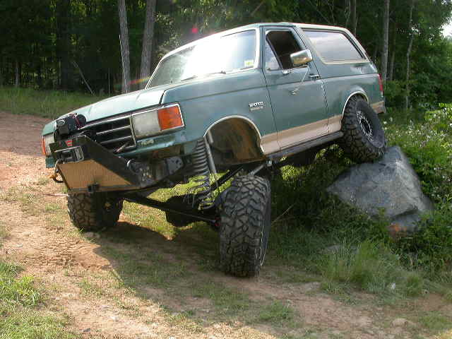

Oh and speaking of that Bronco SAS write up...here is a gratuitous poser pic from when I was testing out the flex for the first time. Not even maxed out there, I just ran out of rock. I still had another 2" travel to go at the shock.
Man, that's what I'm talking about!! I aint gonna get mine to do that but maybe my second one for sure. I see exactly why alot of folks was recommending the SAS now. I'm real sorry but what is an OBA kit??? Is that the thing on the front of your Bronco? If not, what is it? I have never seen a setup like that before but I do like it. I definitely don't mind paying my hard earned cash to good folks. I'm glad you told me about him helping you out. That means alot. Great looking rig and thanks for the info!!
