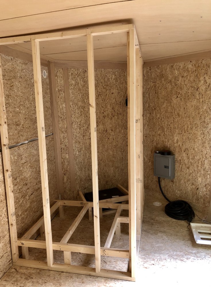

Building a toyhauler with a bathroom. It will have a sink, shower, and toilet. The toilet will go into a small black tank. The black tank will then dump into a portable tank on the ground. The sink and shower will go straight to the portable tank.
Do I have to run the vent above the roof? Could the vent line make a u-bend above the water level and then exit out the floor?

Thanks for the info. Could I go out the vent in the side near the top of the wall? I just got the bathroom framed in today. If that won’t work, I’ll cut a hole in the roof, but hoping not to have to do that.
