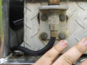

cobra 25 for me, using rg11 coax and a 10' trimmed steel whip.
