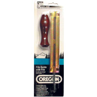

I've never had the need for anything more than this type of sharpener:
The guide keeps the file at the proper depth, and also has an angle reference on it. I usually clamp the saw by the bar in my bench vise to stabilize it so I can get a good position when doing each side. I can't stand even a slightly dull chain, so I keep mine in great shape. It usually only takes one swipe with the file across each tooth to bring them back to 100%.
