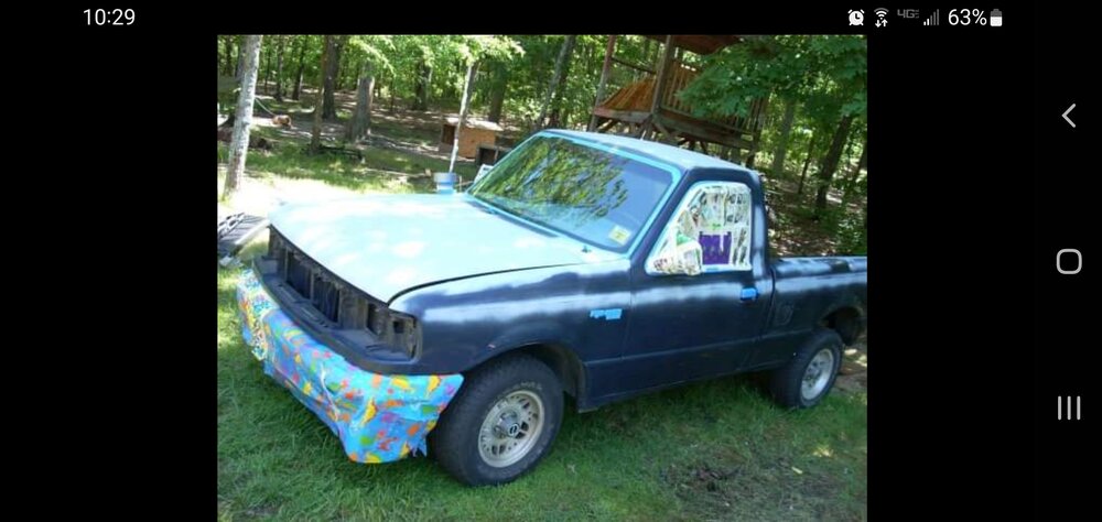

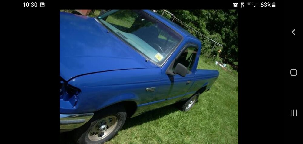

I painted my '94 Ranger around '08 since it had faded to about 4 different shades of blue & I had traded some hickory logs for a silver bed cover.
I used spray bomb primer on the bad spots & tractor paint/hardener from TSC
I didn't use a clear since I was cheap & had no $$$...biggest lessoned learned was to definitely use clear because it will fade if you don't. Helped paint a Jeep years later with clear & it turned out much better.
I was happy with it since it was one consistent color afterwards and only cost ~$100.

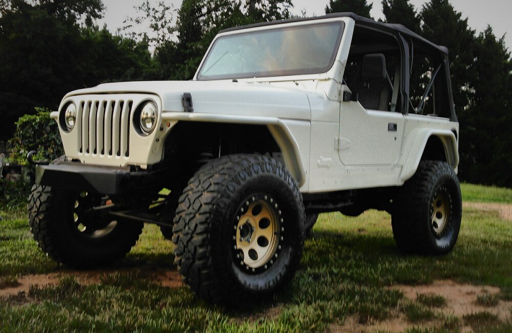

I painted my jeep a couple years ago with tractor supply International white....no clear coat because I just wanted to see how it would last without it. It has a tendency to streak/stain and not clean up though. I think it's dulled out too but its a light color so it's not that big of a deal too me....almost looks like a matte finish now. Ive had some flake off on the tube fenders in places but I think I'd say that's my fault and not the paint.

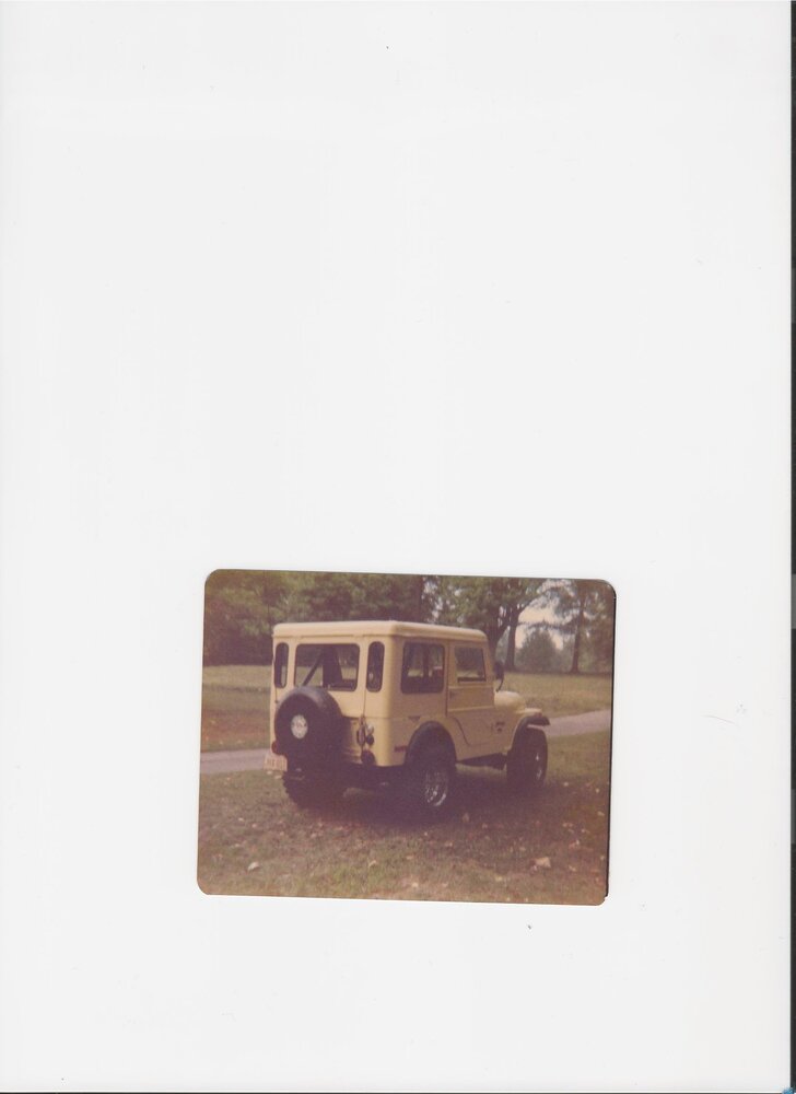

I started out with a 1972 CJ-5, with metal hardtop. It was all Canary Yellow. Factory enamel. It shined & looked great until it rained. Maybe it was the rubber window gaskets, but that damn thing would have black streaks running down it. And the longer it stayed on, the harder it was to get off. I've seen a few white vehicles that tend to do that too. Never seen it on darker colors, not that I noticed.

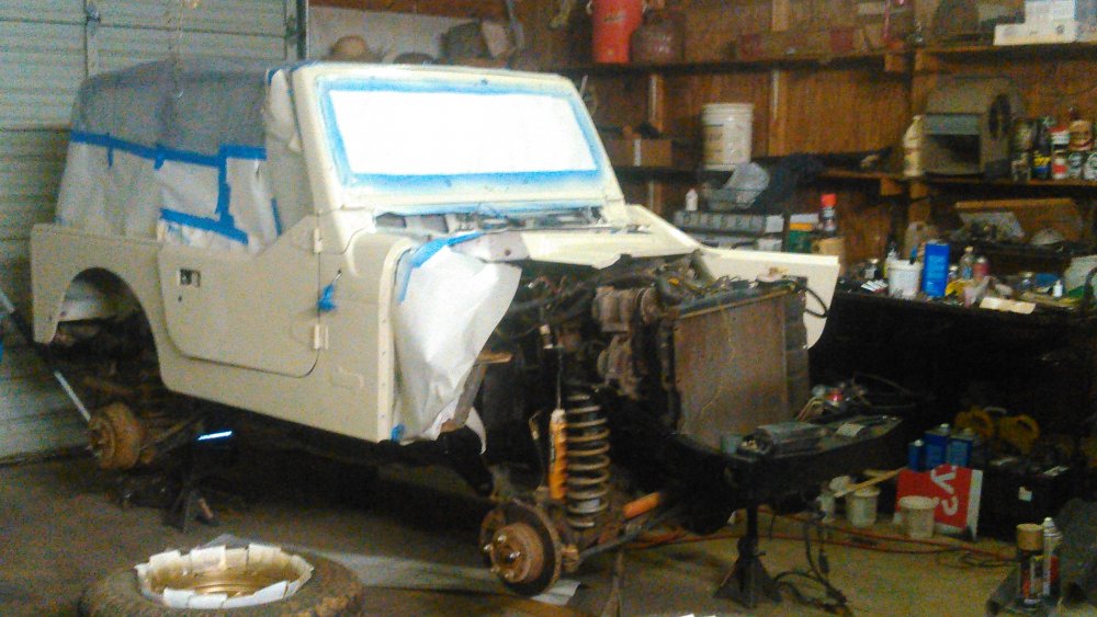

Then there's Monstaliner that I just bought for this one Jeep I'm redoing and that stuff now comes in any color possible and comes in satin or gloss and it's pretty good stuff...not cheap cheap but doable. If you wait a few months, I will be painting my Suburban with the Monstaliner next after this jeep so I'll have a few for you to see if you want.
