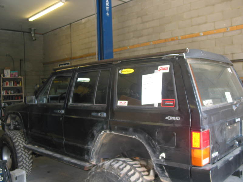

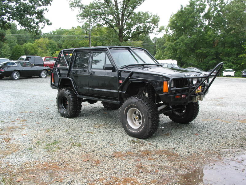

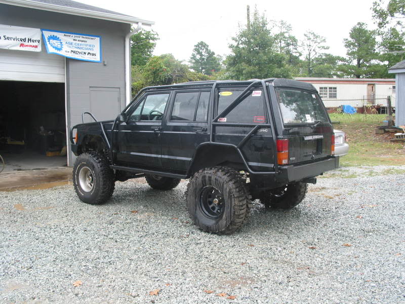

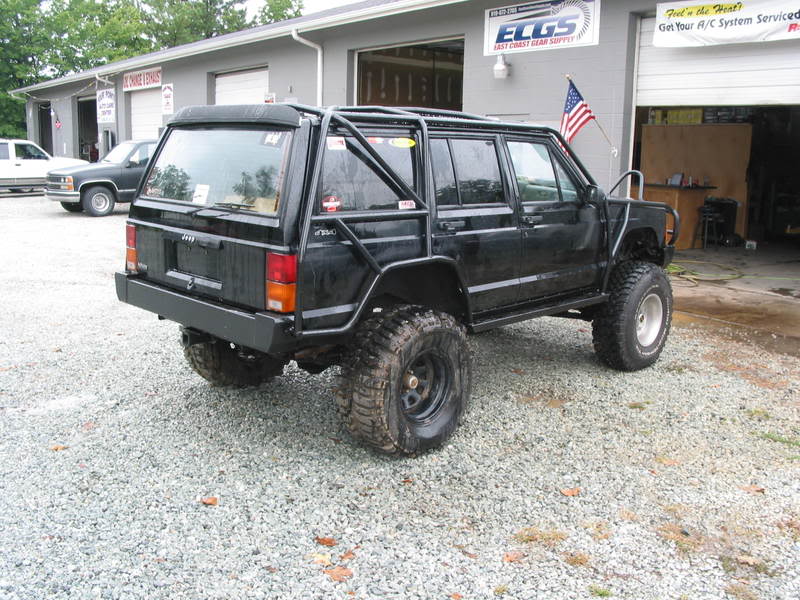

Building an exo for a customer here at ECGS this week, here is some progress.

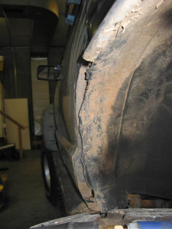

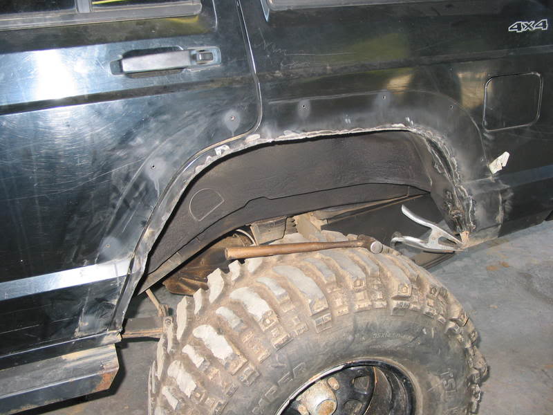

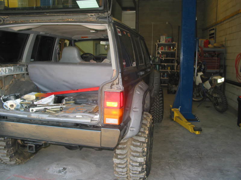

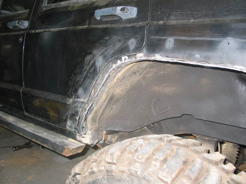

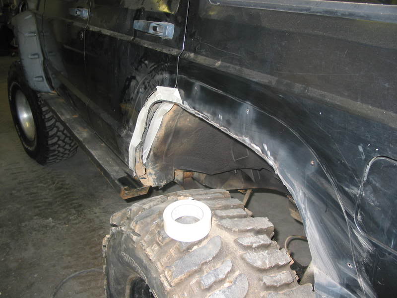

first we had to fix the butchered rear fenders from a PO's trim job that was hidden by the bushwacker flares

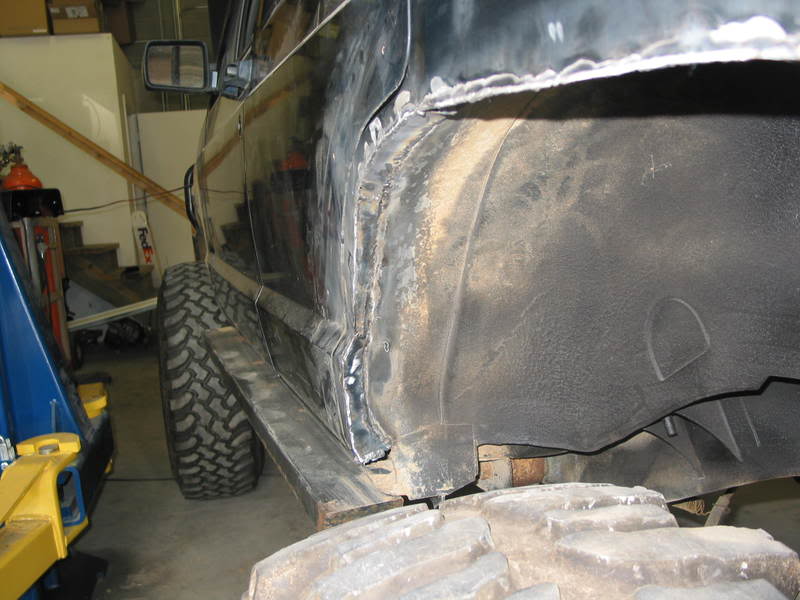

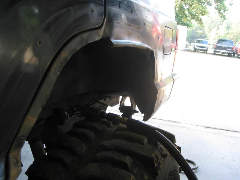

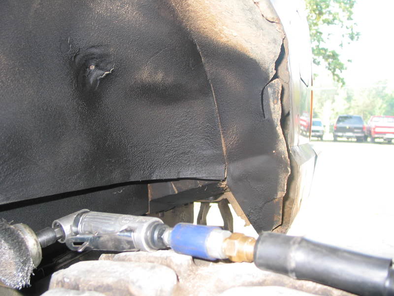

starting to fill the holes....
other side was basically the same deal

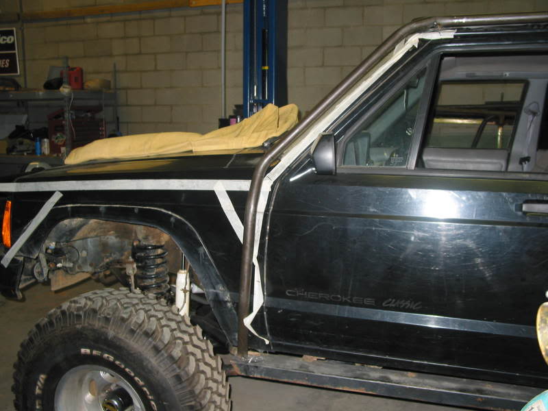

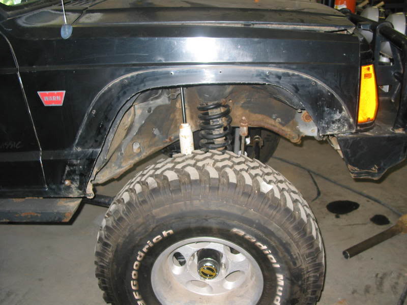

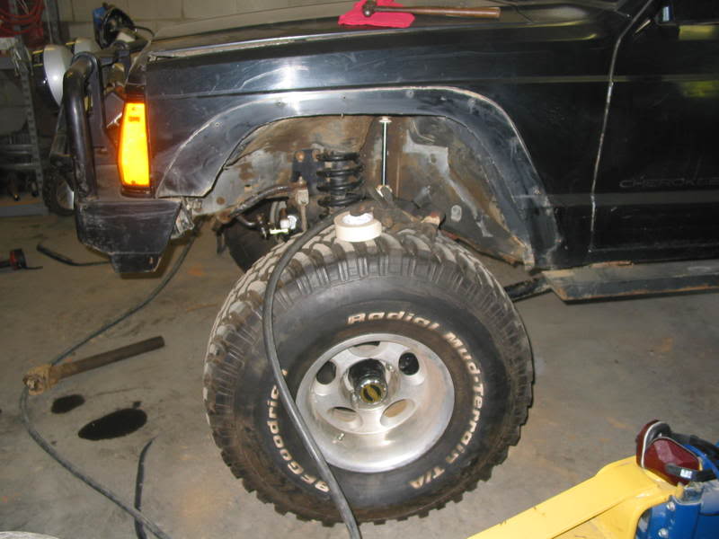

then we cut the front fenders, also were hacked pretty bad (sorry, no before pics)

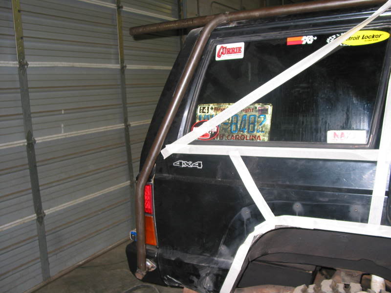

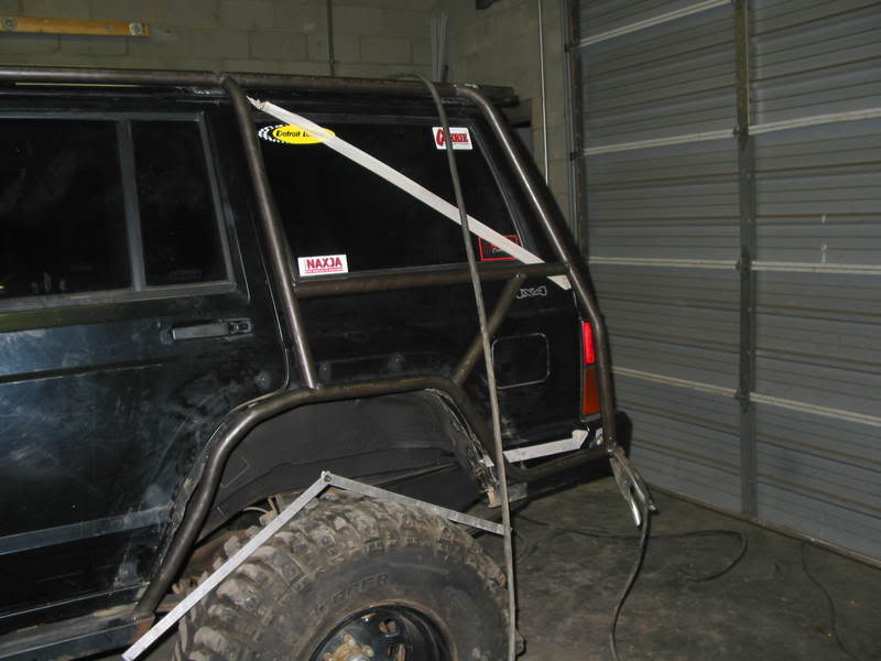

then we layed out where the tubes would run on the body
and started bending

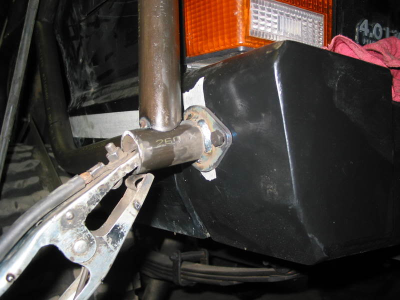

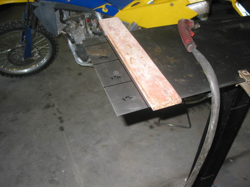

also made these guys so that the bumpers can be removed, per customers request

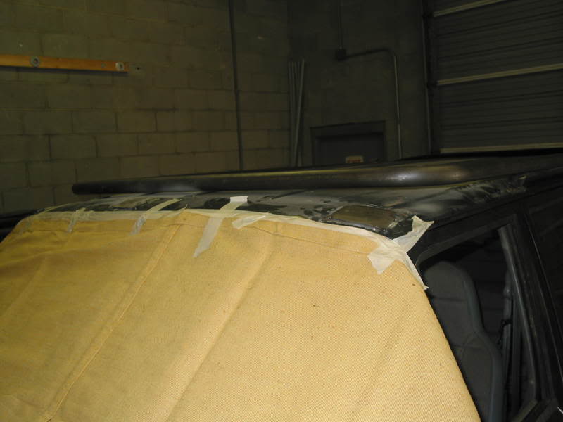

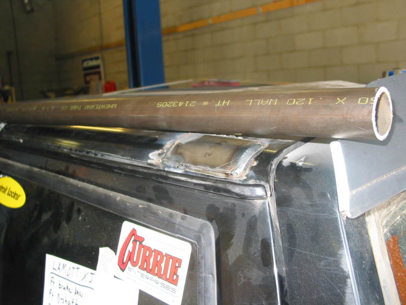

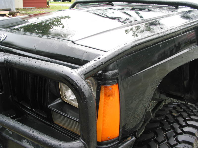

A-pillar and bracing on rear fender bar
thats all we have done so far, will post progress as we go. Lamott if you want any more pics, just tell me

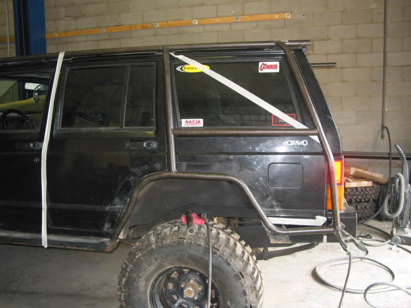

yea lamott, we got the notcher finally and that sped things up a lot. the cage should be mostly finished by tonight, but the driveshaft, brakes, painting and final welding wont be done till tomorrow.
you will have to talk to chase about cost, it varies depending on how complicated you want to get.

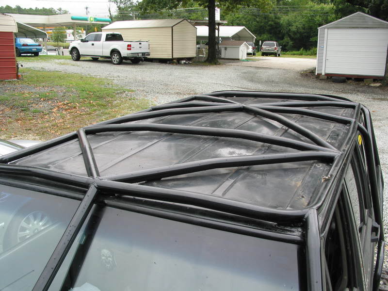

we finished up the bending welded it up in all the accesible areas and then well.............. pulled it off so we can fully weld and paint. looks sweet sitting on the floor.

if you really want an exo give me a shout and we can discuss it. Lamont is a great customer and we have enjoyed doing this one. Which make us happy to do the extra work to pull it off and make it super clean.

Looks really good.. but...
1. did you reinforce the ARB's mounting system?
2. does the owner plan to tie it into an internal cage?
Again... very nice work...
EDIT: did you keep track of how much tube you used? or weight?

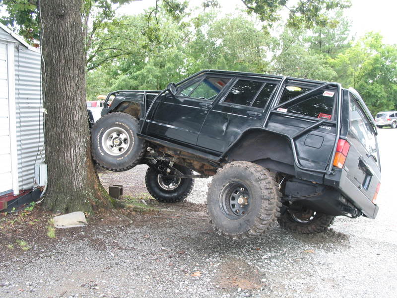

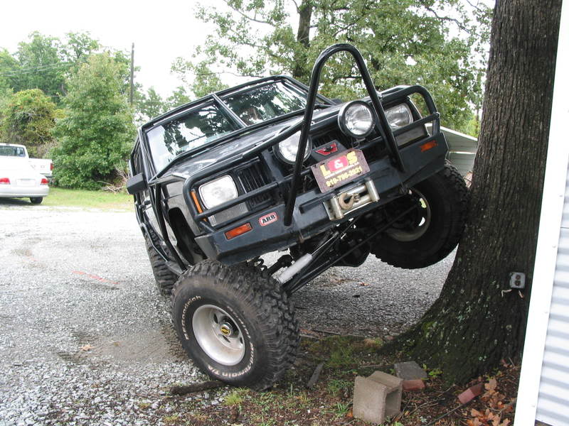

Looks nice. I love the plug in on the tree though!
I dont plan to put in a internal cage. I just cant see putting that much weight & protection in it. I am a little crazy though I might need it...Chase & Jon did a kick butt job and exceeded my expectations. Thanks Guys!!
