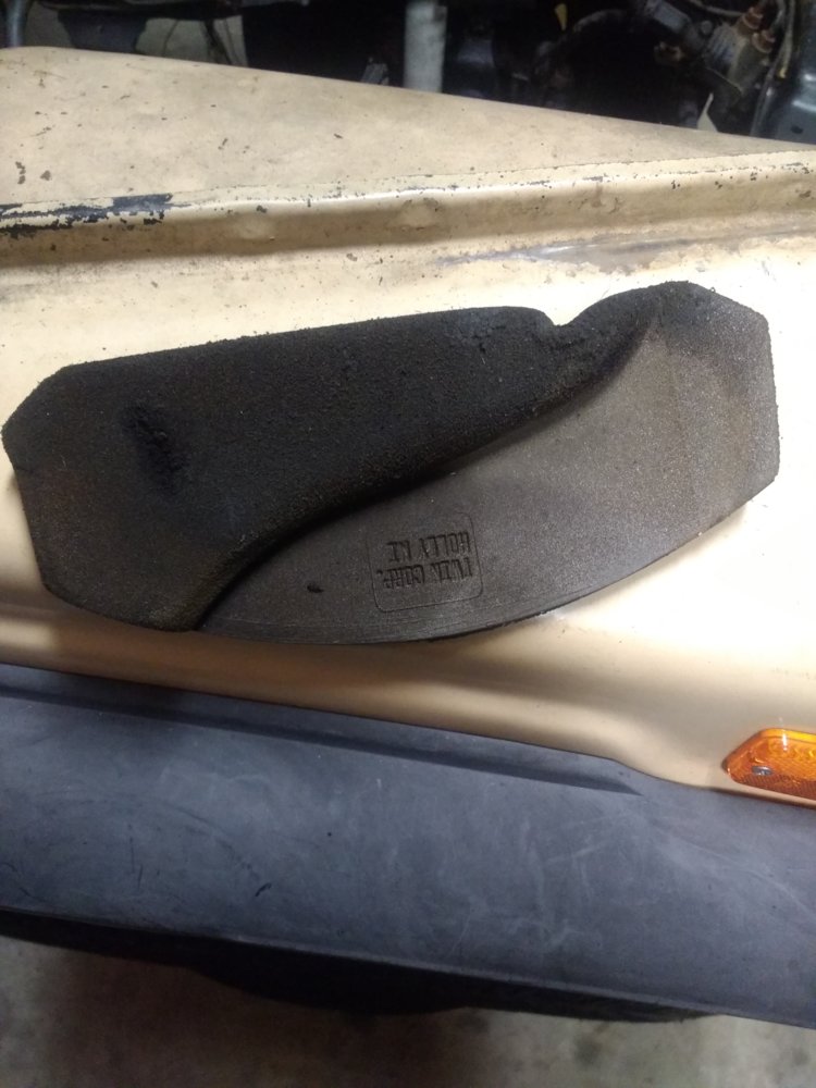

Also, this was under the intake manifold.....should this piece of foam be there?

The foam piece is to just keep junk off the valley cover and knock sensors.
