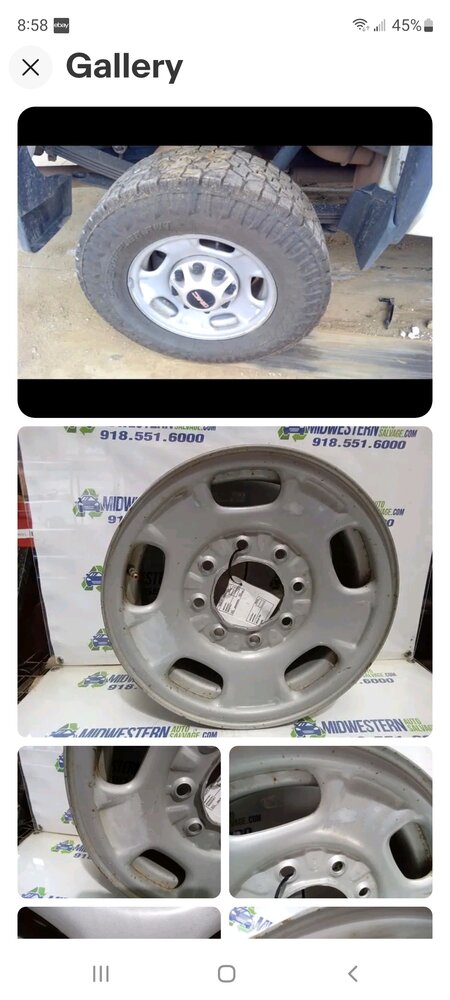

Are there any factory 17" steel wheels from newer chevys? I would like some similar to the 16" that i have from 07. Thinking of upgrading the brakes on my dana 60 and will have to have 17's to clear the brakes. I really like the look of this wheel for my 71.
Found some. Unfortunately, they don't look as good as the 16.
edit, i also realized they went to 8 on 180mm. No dice regardless

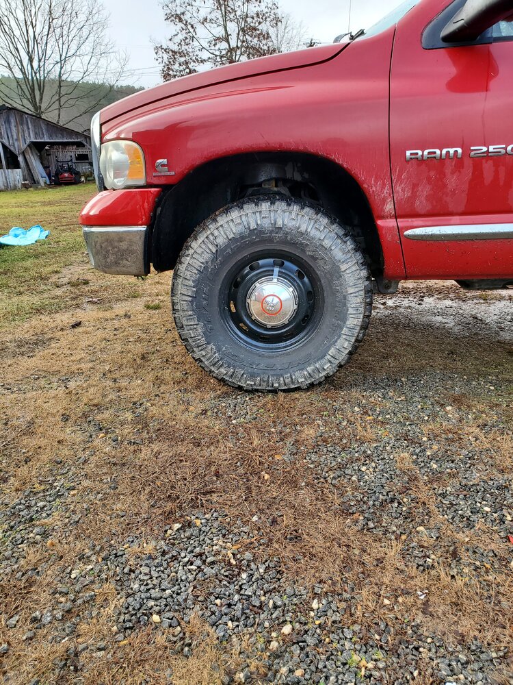

3rd Gen Dodge steel wheels are your best bet.
They'll look just like the ones @ramjo has on his truck.
@justjeepin86 I think 3rd Gen Dodge steel wheels would look good on it with a center cap. They kinda look like an old chevy rally style. They do have a lot of backspacing which might be an issue without spacers.
Eventually, I'd love to get these '70's dog dish caps to work with mine.
