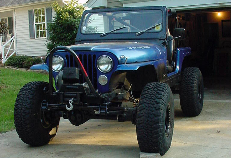

I had FSJ waggy dana 44's on my last cj7 and used a 90's s10 dual diaphram booster with a shortened push rod and a 90's wagoneer master cylinder with the cj7 booster bracket. Worked great! Stock cj7 proportioning valve and would stop 37" tires on steel heavy beadlocks no problems! The rear dana 44 had a disk brake conversion using s10 front calipers and 88 chevy stepside rotors with A&A weld on brackets.:beer::D
