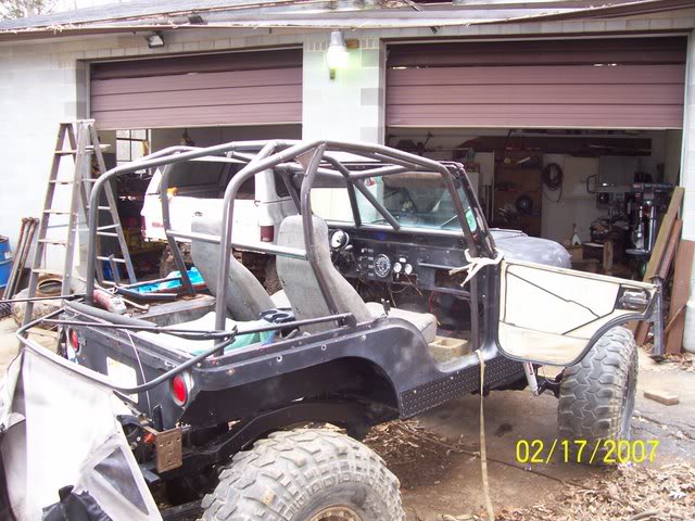

Heres a cage that Greg Smith is working on for me.
Nice. Will the top still ft on it?
Nope, This cage is actually coming out next week and a new one built, that will sit a little lower.
Maybe it's me. Maybe I am wrong, but it looks like a hard flop on the lid and it is designed to come down on your head in the middle. I have never seen a center tube bent like that.
X2 with what chip said.... id prob try to make the main hoop(behind head) out of 1 piece, and have it strait.... the bent piece will need to be a ton stronger the withstand the same force that a strait one could....
and i would probly try to have that same hoop be 1 piece all the way across and the rest tie into it.... and prob the same with the top of the hoop at the windshield.... remember that triangles and strait lines are your friend... course ive been wrong bfor
cool looking cage though... and if you never get upside you wont have to worry bout it haha

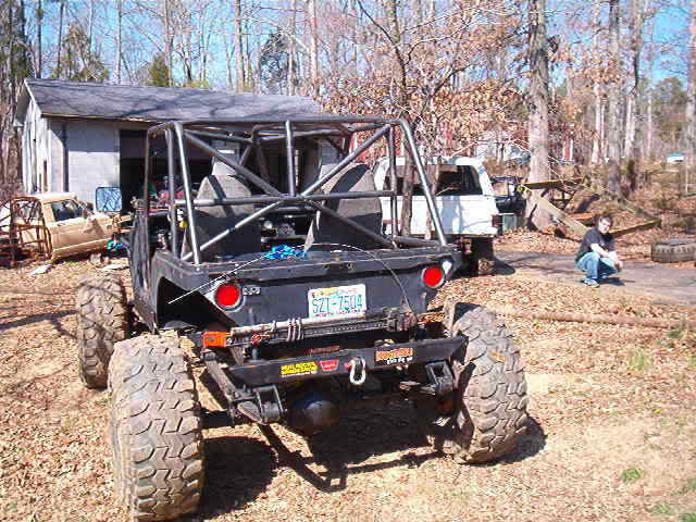

finally got it installed
I still need to make the frame connectors and the seat mounts.

The cage looks awsome. Nice jeep too. Lets go wheeling sometime.
That's a bad ass cage!
How's the visibility? Can you get some pics posted up when there's someone in it?
