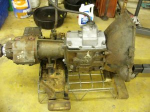

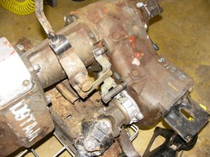

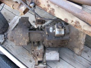

I cleaned a tranny and t-case this way a few weeks ago, heres what I got with basically no scrubbing (before and after):
