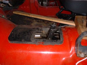

jeepn-jason Well-Known Member Joined Mar 20, 2005 Location Greensboro Oct 6, 2006 #1 I was just wondering if anyone here has done this? It looks like the shifter area of the tcase will hit the trans.

guffey24 Well-Known Member Joined Jun 7, 2006 Location Hendersonville, NC Oct 6, 2006 #2 the shifter area should clear, I havent done this with a t-18, but did it with a nv3550 I had to heat and bend the shifter for it to work, but ended up being okay

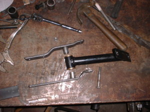

Yay!Gurrr Better Faster Stronger Moderator Joined Mar 17, 2005 Location N. N. Raleigh, NC Oct 6, 2006 #3 I cut my shifter part off the front of the d300, i didnt want to slice the floor open. I made my own twin stick and put it exactly where i wanted it.. i have some 1" tube that bolts to the levers
