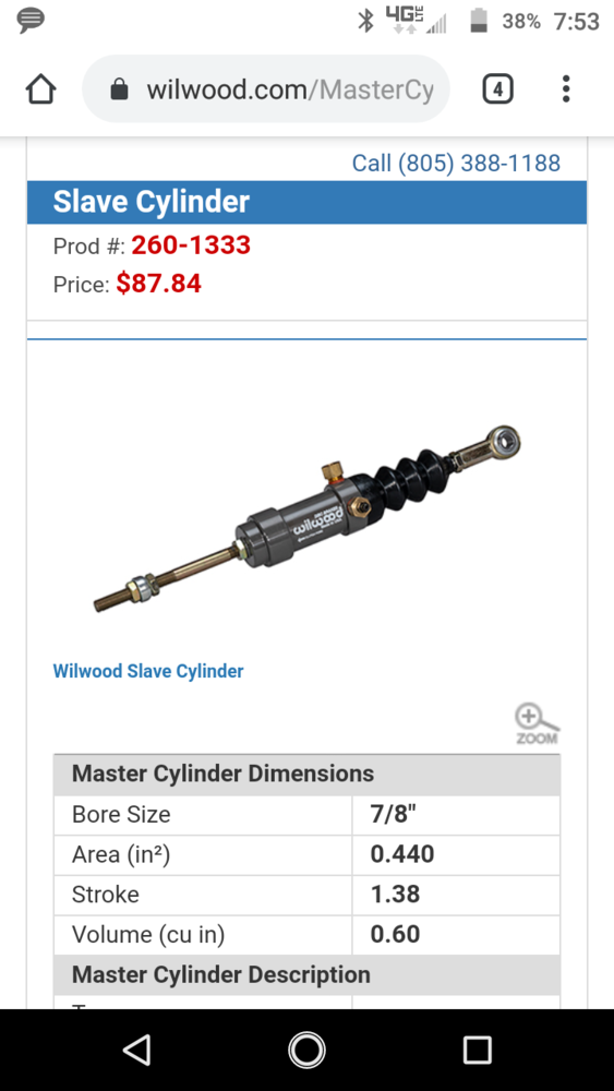

I have this slave.
https://www.summitracing.com/parts/wil-260-1333
1 3/8" throw for the slave. The master I believe is a corvette model(its been so long since I bought it, I forgot).

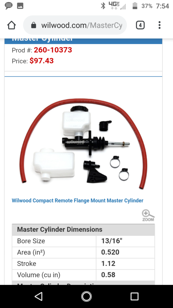

This is what I'm thinking, I'm not getting enough fluid to move the slave. Maybe this could work?
https://www.summitracing.com/parts/wil-260-10373

If the bore x stroke matches the original application, it will work. Actually if the displacement volume is the same as the original it will work. (Though a bigger bore, shorter stroke will make the pedal force higher, where as a longer stroke smaller bore will lessen pedal force)
You can figure out the volume you need if you have the dimensions of the slave.. then you just figure out how much stroke you would need for a given bore size, or bore size from stroke available.

So you'll lack .02 cu in of fluid from full travel.. or..
.02/.520=.038,
about 1/32 in.. which is pretty much nothing.
What's your existing master application/bore & stroke? If you can tell me that I can tell you how much it should travel as it is setup.

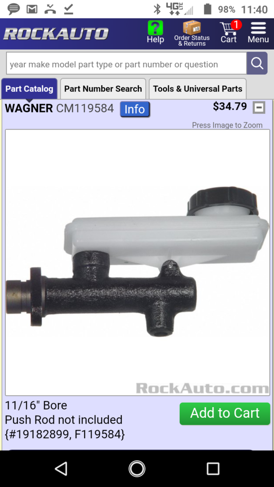

Looks like a Nissan or Toyota master. I'll look up one for a 90 1500 with the nv3500 and see what the bore and stroke is, likely similar mounting to what you got.
Stroke I can't find. However the matching slave is 13/16 bore and I can measure stroke on the master if you want.
