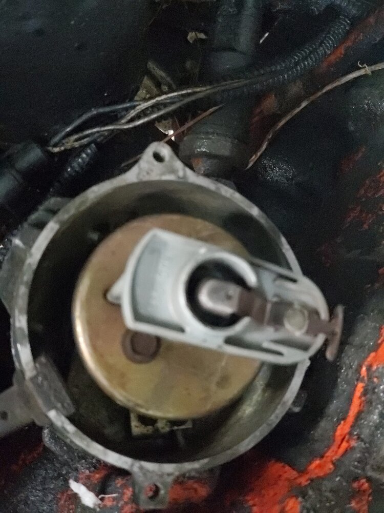

I'll bet you $5 and a dirty sock that your dizzy is installed wrong.
Care to elaborate? I reckon it's certainly possible it's on wrong.

Sure thing
First, let's verify if the dizzy is correct or not.
Remove #1 plug, turn engine via balancer bolt (3/4") by hand until compression is felt through #1 hole. Align the notch on the balancer with the "0" mark on the timing cover. You're at #1 TDC compression stroke now.
Remove dizzy cap, rotor and cam sensor. There's a hole in the dizzy body and a corresponding hole in the metal cam sensor reluctor wheel. Do the 2 hole line up so a 3/16 screwdriver, drill bit, etc will pass through? If so, it's timed correctly. If not, proceed to next step.
With timing untouched, pull dizzy, use a flat screwdriver to turn oil pump drive to approx 10 o'clock. Put that 3/16" diameter bit back in the dizzy and drop it in. If it doesn't fully seat, turn the oil pump drive to 11 o'clock and reinstall.
Holler back as needed. Your symptoms are those of a incorrectly installed distributor.
PCMs in early ZJs rarely, if ever fail.

Had no idea about this, so its certainly a possibility. I'll see if I can get time this weekend to check that out. Thanks.

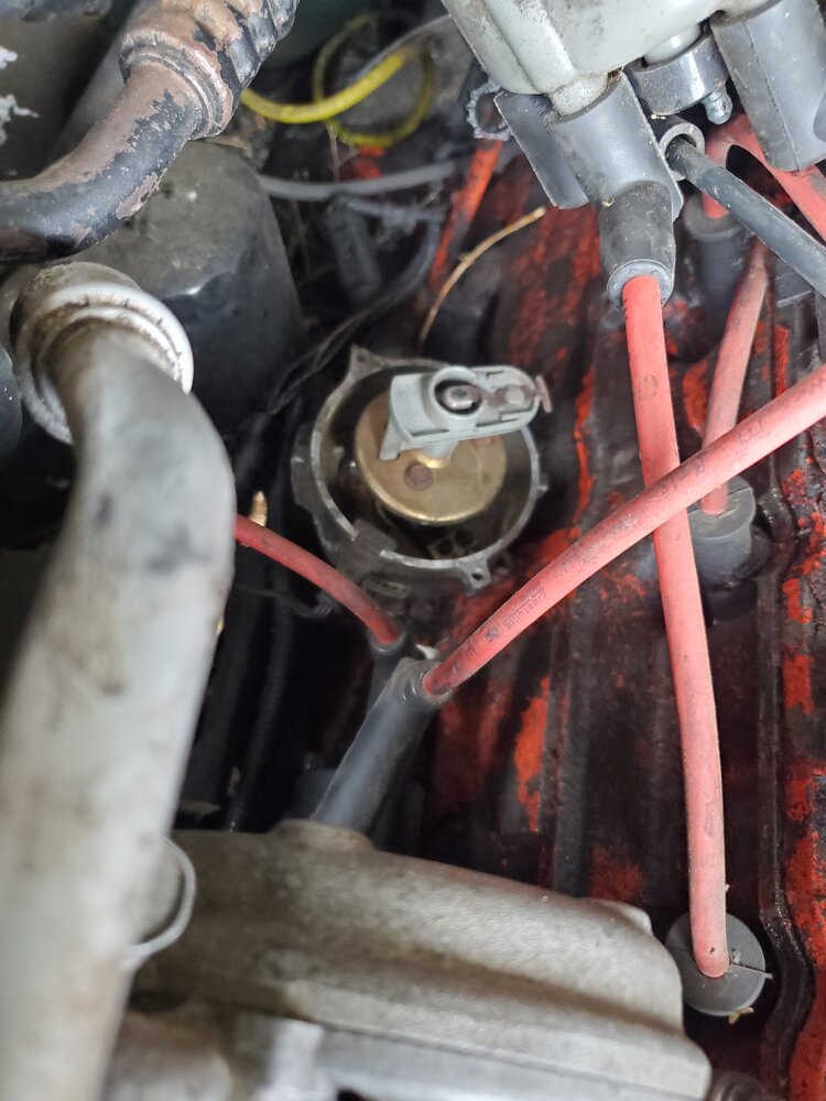

So, my dizzy doesn't look like it's right.
