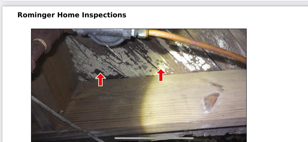

I think the issue is cold and hot spots. You could have an ac leak into a cavity that locally changes the dewpoint in a section. The further from the leak the less effect. That leak could be uncalked trim an uinsulated wall cavity with electrical box etc. I have one of those spots where the gas line runs to my stove. It locally molded right under the spot where there’s air leak, but no evidence of moisture on the subfloor on the other side of the joists
There was also a noticeable draft in the winter in this area
Good point. Ideally you want to seal up those air leaks, but sometimes easier said than done.
