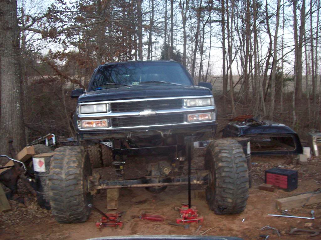

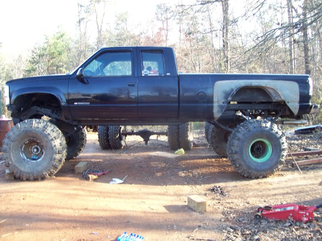

well cant remember if posted my truck before but here it is running 18 inches of lift in the front an 20 in the back 2.5 ton rockwells an 44 boggers plans to install a div 205 transfer behind the factory borg worner transfer case for like almost a 5to 1 low range let me know what yall think

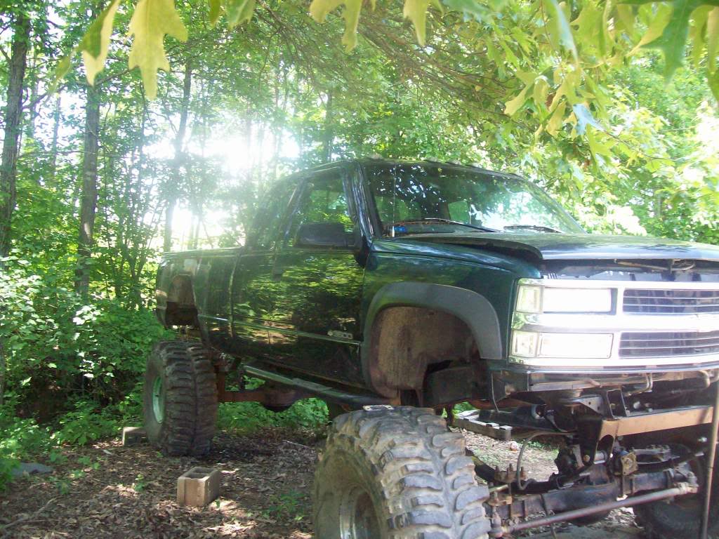

Is that dual rear wheel axle for it in the 4th picture?
I think he needs to put a little lift and some larger axles under that thing!!!
Naaaaaa..... Id say that should get it done.
Mud or Rocks?
Also I think the dual rear wheel axle in the last pic would be tough as hell looking!!
lower it down and cut the fenders....then raise hell
Is it SBC or BBC?
diesel an no it doesnt have dually in the back. that was actually the first pic i took when i put the front in before i got the back in . an yes its for trail riding . an no not for no rocks .but love to play in the mud dont have really any trails to ride around here but i got a buddy who has a 650 acres of farm land an plenty of mud to play in. bigger is better an besides i dont like cut fenders 44s an no cutting . the 5to1 is for the deep mud to help spin those boggers
no i dont have it done yet i lost my job tuesday so could be a little time before it gets done unless i can find some one to buy my 38 x13x16 swampers for 400 dollars well the 5to1 will be when its locked in the second fourlow will run close to 3to1 in 4 high with the first case locked in low range
planning to try the grudge pulling i think it will be fun
the 5 to 1 will probably be too low to clean out the boggers, would be great for grudge pulling!:lol:
you got this thing done yet?
5to1 will be fine if you use 3rd, 4th, and 5th gear.
i know on my four door ford in 4 to 1 low range and in overdrive it will not get enough wheel speed to clean out my 44 boggers, and thats with my wife driving it on the rev limiter!
she bounceing it off the rev limiter . hahaha im going to try it an see whats up nothing else i will just leave it in 4 high in the second case we will just have to wait an see
