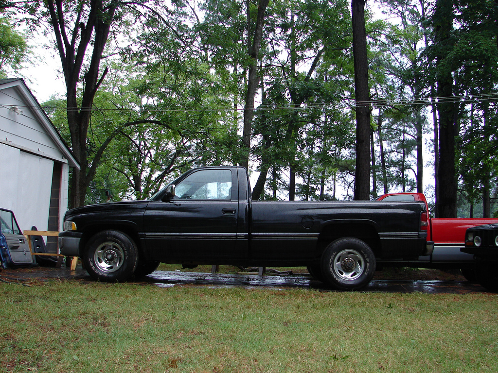

Front lowered 3", all else stock:

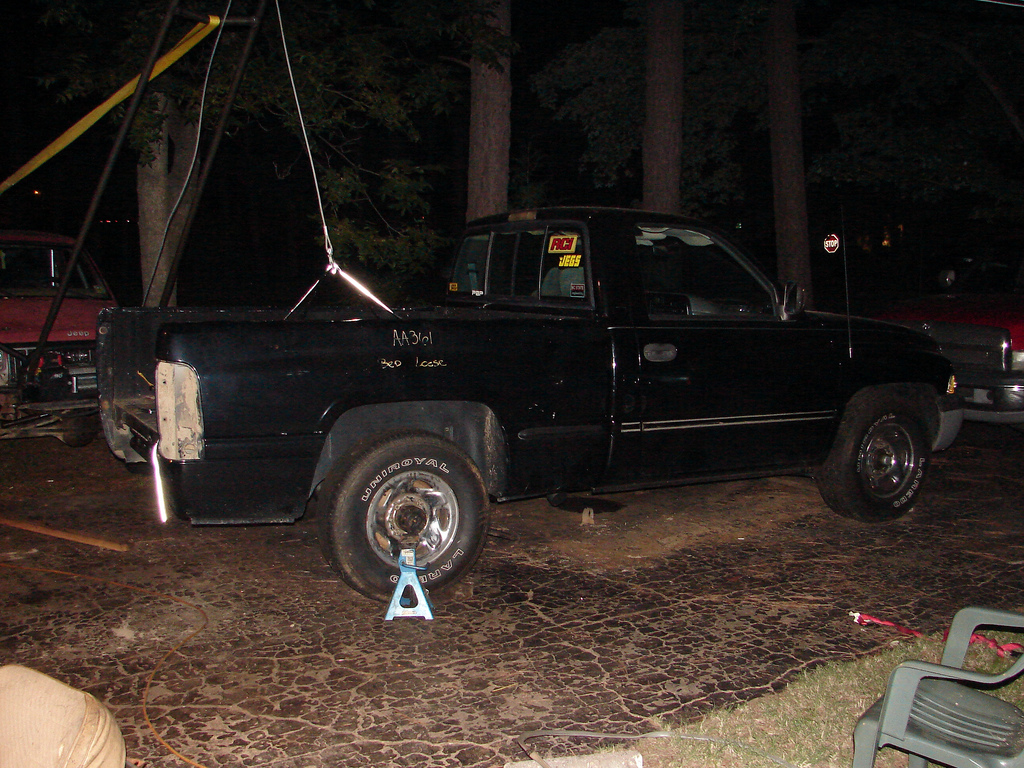

Then one night, the frame dissapeared:

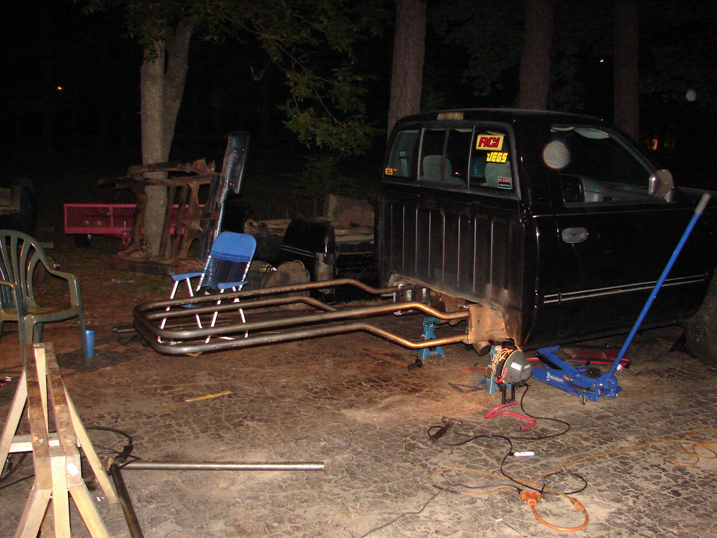

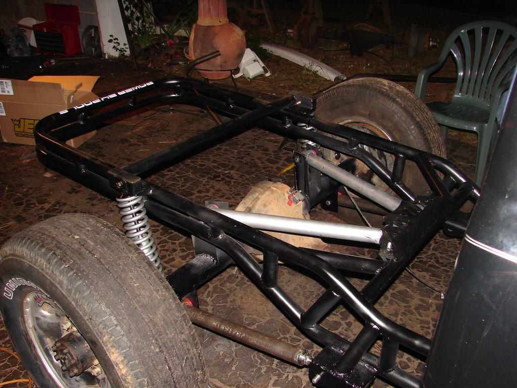

First couple tubes, this is when i would really start envisioning how it was going to turn out.

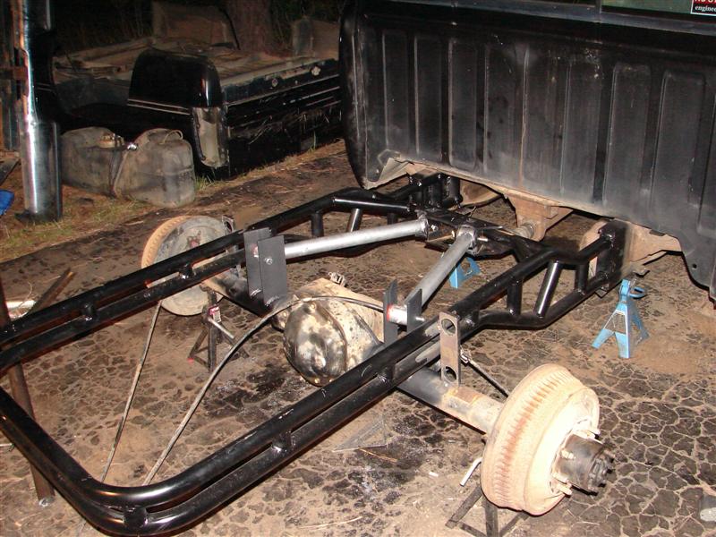

Frame getting close, upper links in.
Links and COs mounted. If you wonder about all the stickers, i've been trying to find all i can stick on there while joey is away.

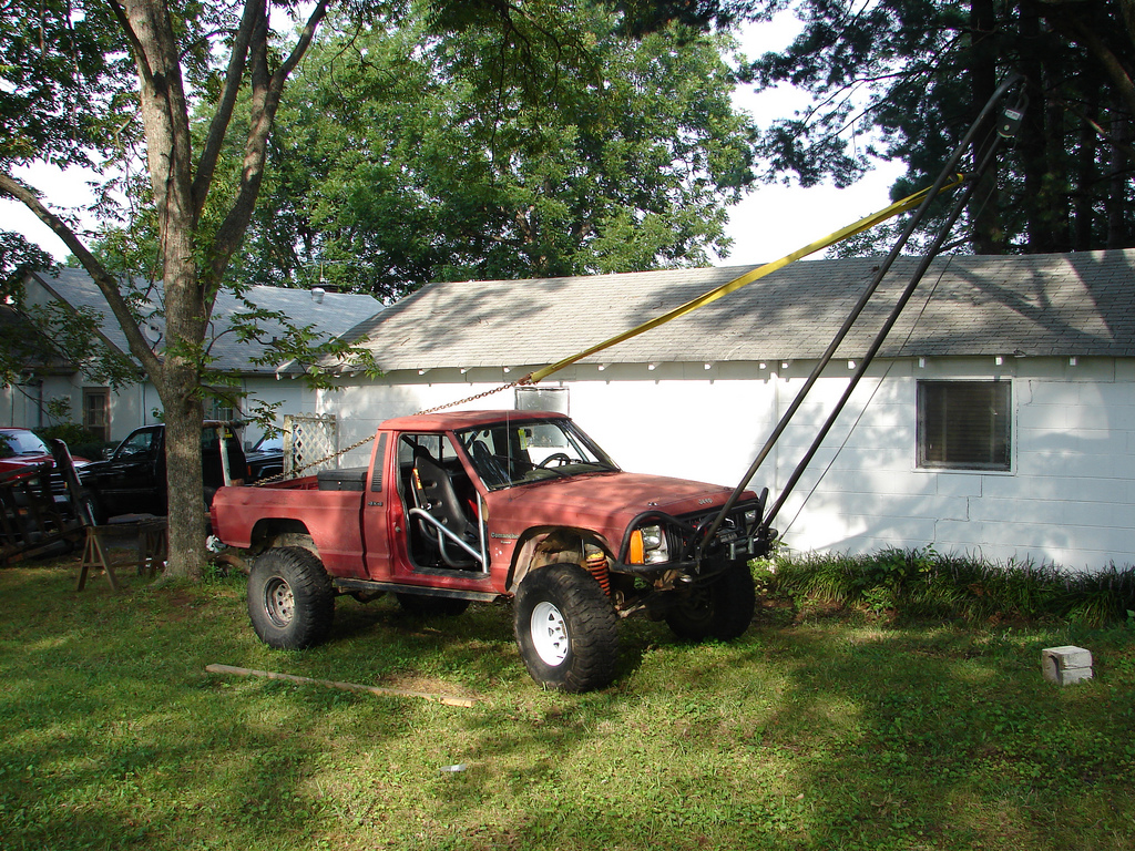

Next, we built a yard crane to help move axles, frames, and beds around the yard.

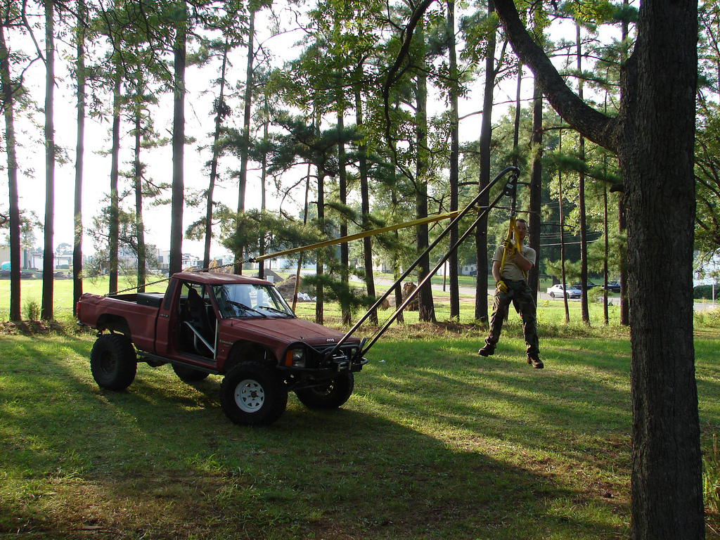

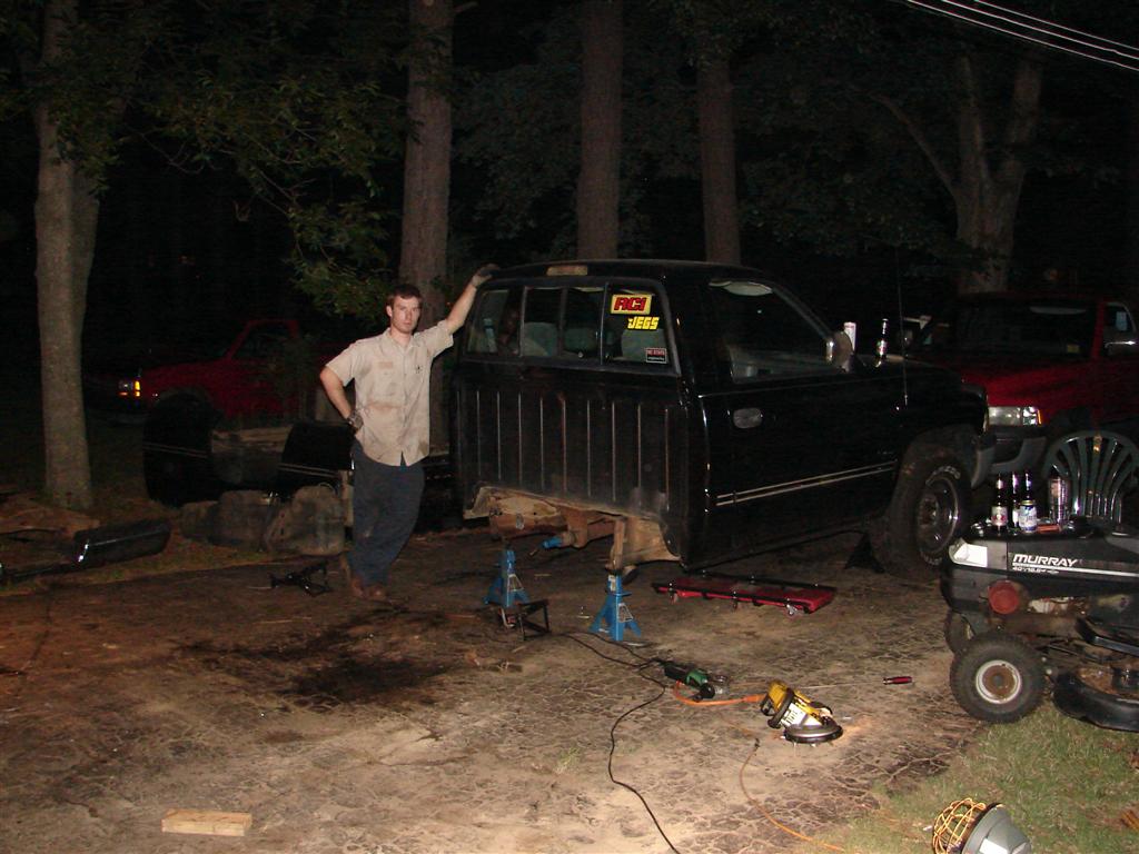

Had to test it of course, and since some people think animal testing is cruel, we just had to use joey instead...
Here is where we sit now, bed mounted, just need fuel cell and brakes plumbed, I picked up the driveshaft a few minutes ago from being shortened.

Lookin good. I did the same thing to a 94 2500 last fall except I didn't back half mine. How did you lower the front?
Joey could answer for sure if he gets on here, but i think 3" Belltech springs and we just went ahead and replaced all the rubber with poly, and replaced the ball joints while we had it apart.

Thanks man, i think it is turning out good. Once again, Joey will have to answer that, but i guess the short answer is he didn't feel like it. Didn't want a compressor, and i think the COs will be good for what he wants, just worry free cruising. We do need to adjust the spring rate, these are way stiff, and it is sitting pretty high in the rear. It will hopefully end up within in inch or so of being level, but i doubt totally level.

Yes, BellTech 3" springs up front. I wanted to go as simple as possible in the rear, so CO's were the only option in my opinion.

Did you get a true 3 inch drop in the front?
