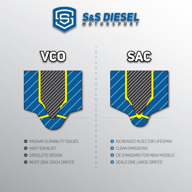

Generally, a leaky/hung open injector will wash fuel past the rings and dilute the oil. Check it and smell for fuel. A hung open injector will usually make it white smoke too. Unburnt fuel from lack of temperature. As an LB7 owner, I know allll about that 😂 It's also absolutely worth it to go ahead and upgrade to a SAC style injector nozzle. They last much, much longer than a VCO nozzle and aren't plagued with leaking issues.

Just to follow up, that's what I meant with SAC vs VCO. LB7s and all 5.9 Cummins motors used the VCO nozzles and they're very susceptible to leaking with the slightest amount of pintle wear, trash in the fuel, or water intrusion. If they're a 6 hole nozzle, then the pintle has to seal ALL 6 holes and a seat around the inside of the nozzle, or they'll leak. As you can see, the SAC style just seals up the shoulder. Much more better!
FWIW, every Duramax after the LB7 uses a SAC nozzle and Cummins started using them when they introduced the 6.7. If an OEM starts using them, there's a reason!
