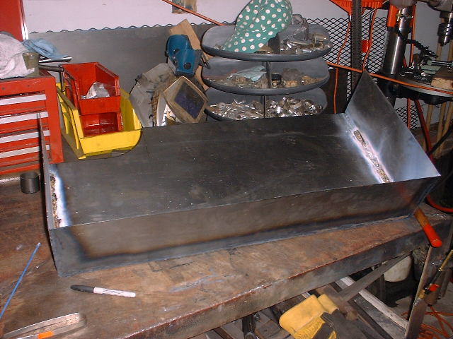

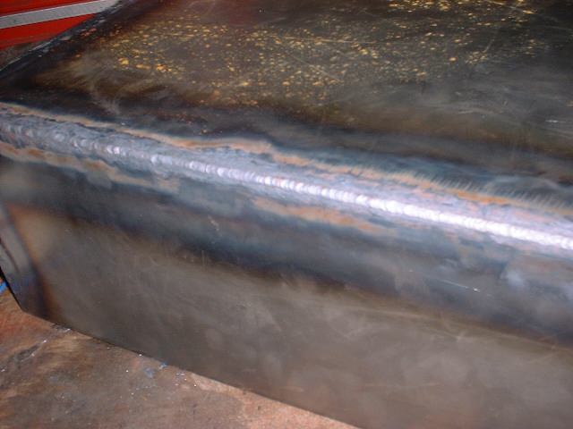

Randy (chasespop) has been on me for a while about my gas tank. I finally started welding it together so i snaped a few pics..
Its Mig'd on the inside, Gas welded on the outside, and for Ha Has i im brazing the inside... Not much but its started...
btw: its 14ga steel construction, ill have a flop tube inside for fuel pickup and found a cheep fuel sender unit that will work the CJ guage. (thanks braxton for that tip)
more as i make progress

Looks good, but do ya think your big ass tires might hit it when you twist up the axles, given how wide it is? :lol:
ya missed the joke, Yag,,
if the tires hit it where the tank is located ill have other much larger issues..
Ill snap a pic tonight during a test fit..
But basically it fits between the frame frails and will be in front of the rear axle, above the rear diff chunk. There will be a notch cut out to allow for extra drive shaft clearance.
Im using the stock YJ rear cross member, only hanging the tank on the front side :) that along with some brackets in the front to hang it from the stock tub floor...
