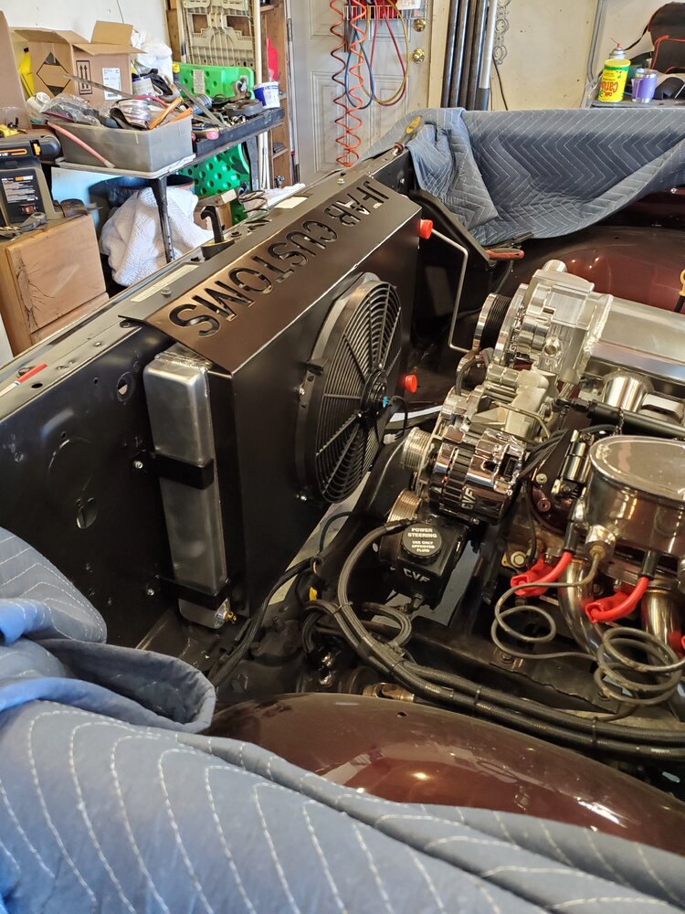

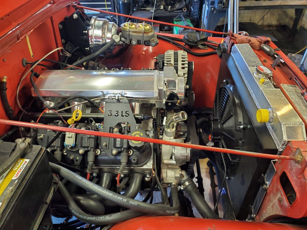

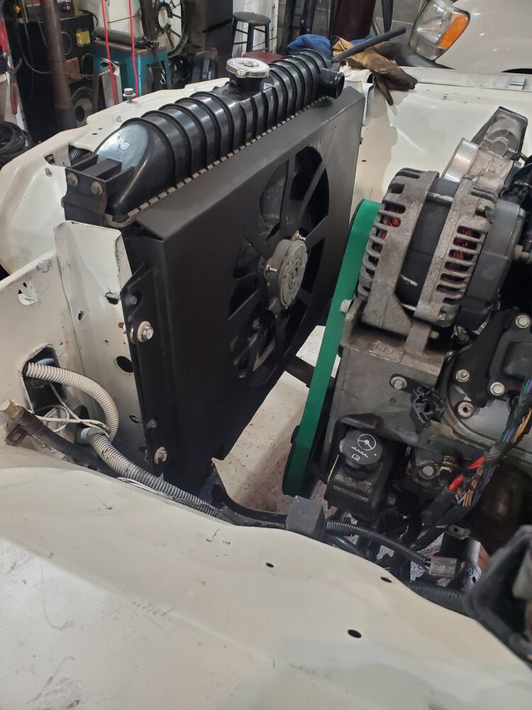

I make shrouds for all my LS swaps, have several files already, most recent one I drew was to accept chevy stock truck fans which are very strong fans, factory used 2 of them but one on this grand wagoneer I just finished is way plenty.
few others I've done as well
