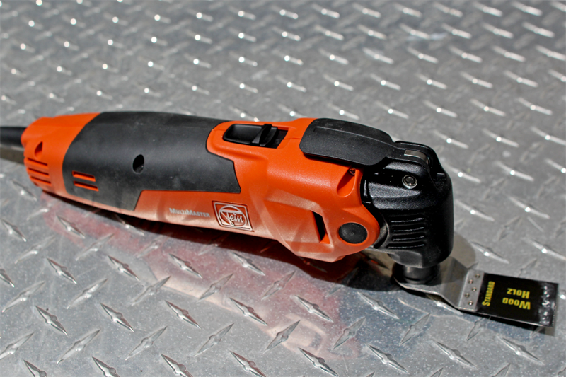

I would use this as a good excuse to buy one of those oscillating saws. I kinda want one, but I have no reason to justify the purchase.

I have owned a Fein for 12+ years and use it as the time in my business. It is expensive but worth every penny if you work with one. Buy a cheap one from Harbor Freight and see how much you use it. If you decide to upgrade skip the others and find a Multimaster on eBay or Amazon .

X2 on this, they are very useful for soft materials.

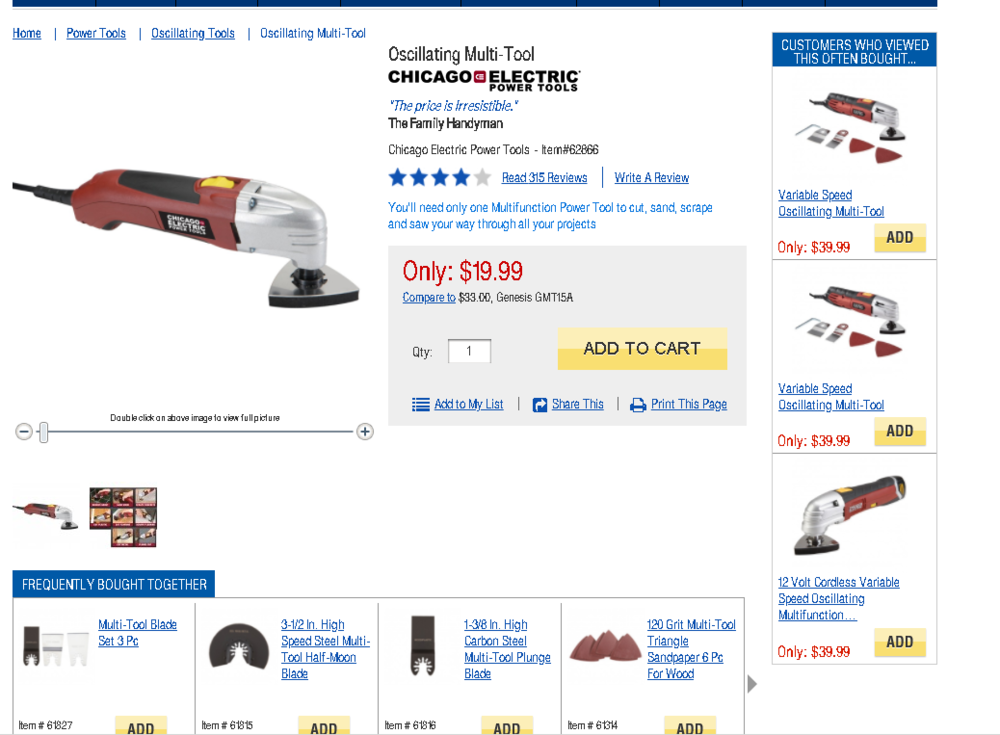

Harbor freight. Oscillating saw. They have a huge variety of blades. The Fein created the market. Harbor Fright made it possible for you to buy one for a job or two and not feel bad about it. I've had the variable speed HF unit for years. I'm ever impressed with it.

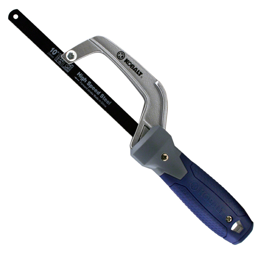

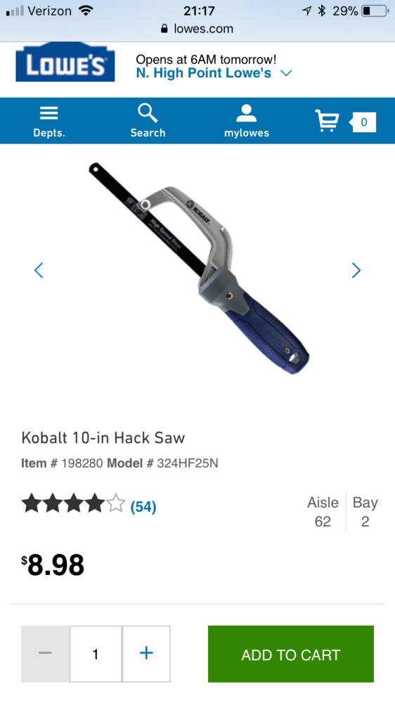

I'd use the stub hacksaw, but with a decently coarse blade because you're just cutting copper.

$20, comes with the blade you need:
Oscillating Multi-Tool
And the blade might even last through the entire cut! Some of the name brand blades at Lowes/HD fit these (Rockwell maybe?) so you have options for better and different blades. I bought one of these like 5 years ago to make one cut. Rarely use it, but when I do, nothing else will suffice. $20 well spent.
