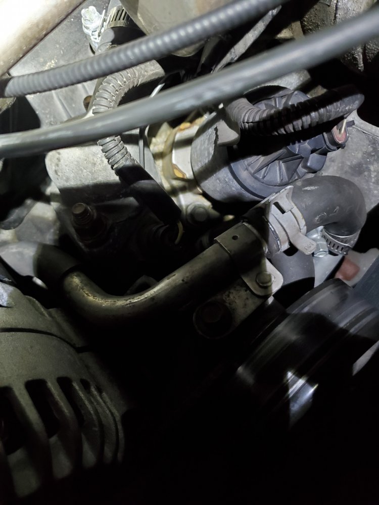

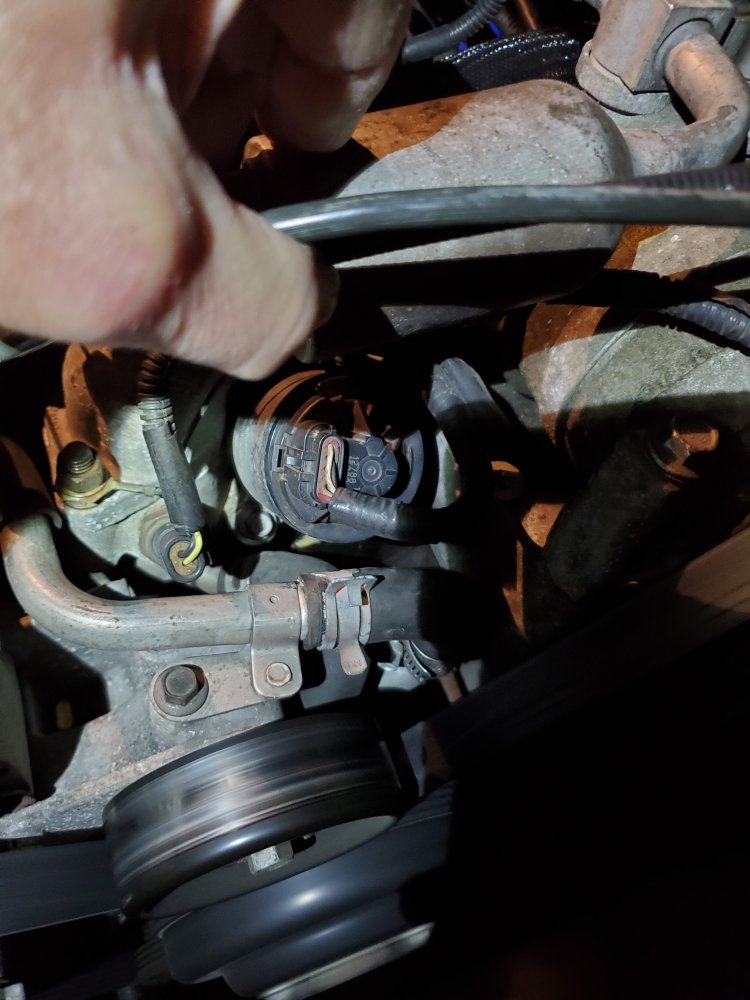

Spiders in and it's running better then before it started to misfire. It had a shake at idle that made the console rattle before the misfire. When I went to pic up the truck w the new spider It was not misfiring but the idle was low and it was still shaking at idle, 5 miles from home and the engine light came on. Got home and it had a P1404 code....... I'm apparently getting to old to wrench. While trying to find the cause of the misfire weeks ago I removed the EGR and cleaned it and re-installed it as the sun was going down. I looked at it tonight and noticed the EGR was touching the heater hose from the water pump and I knew I screwed it up. I installed it rotated 180* ! I also found the gasket fell out while I put it on backwards at sundown, it was not there when I removed it tonight. Got a gasket and rotated the EGR and now the truck is running w/o the shake and it Idles @ 700 rpm...:dumbass:
