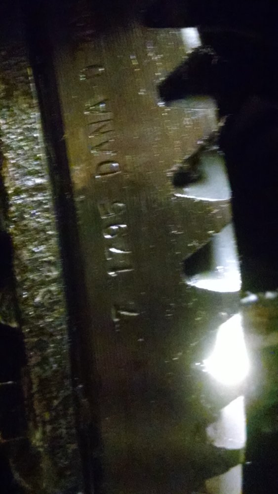

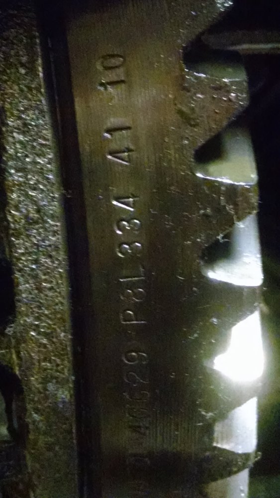

Trying to confirm gear ratio. Can anyone tell me from the numbers or do I start counting teeth?
I assumed so, but I wanted to make sure.41/10
Drum roll
4.10s
41/10
Drum roll
4.10s
