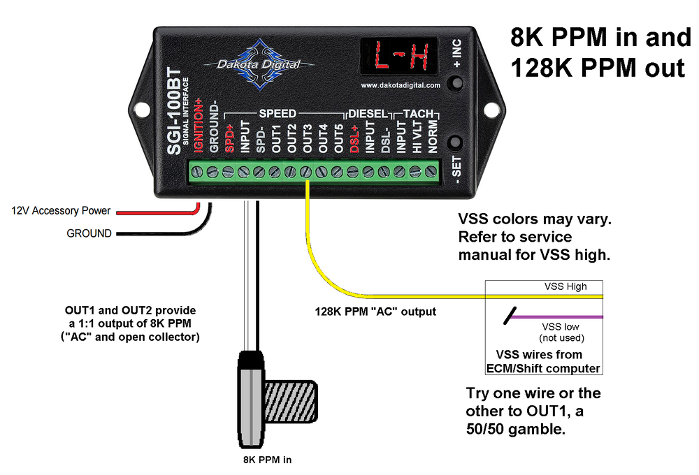

anyone have experience with this unit..my first time having to use one.
its wired in, works but speed reading/ output is off therefore my shift points are off.
08 5.3 4L60 into 88 Grand wagoneer with original np229.
I just need help how to calibrate it from here and the instruction manual isn't much help cause when I read it its just too complicated.
(Dakota digital tech guy got me this far but was hoping to get this fixed/adjusted Sunday to really test drive it)
thank you very much
