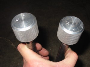

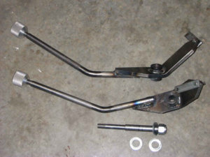

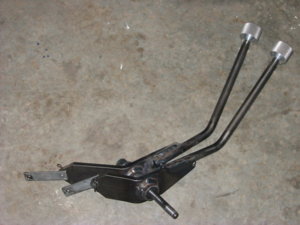

Here are a few pics of my twin stick shifters I put together. I used 5/8 cold roll for the rods and the stud, and 2"x5/16 flat for the lever parts. The assy is a little over built, but that never hurt anything. I also turned the knobs myself. It was a good lathe work project with all the turning, treading, and knurling. I'll get a finished pic after some paint and final installation.

nice work.. those knobs are sa-weet!
