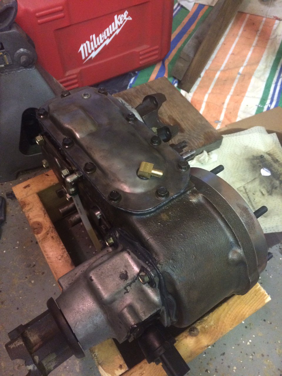

I have routed the breather tube to the same spot as the old tcase breather, right next to the master cylinder. Now since I am flipped the vent is different. As you can see below I tapped the tcase for a sight tube/vent combo. It ran street speeds just fine but as soon as I started doing 55 the oil started coming out.
Here is the vent/sight set up(minus the tube).

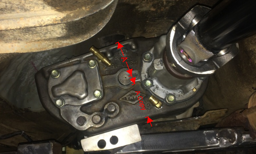

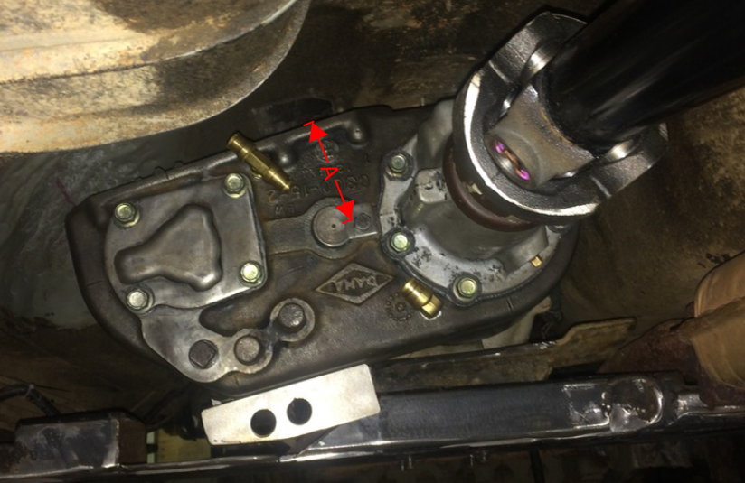

I've always read to fill halfway up the center shaft. It looks like the distance from the center to bottom ("A" in the picture below) is shorter than center to top, could just be the angle of the picture though.
I would try to match that when filling yours and see what happens.
That is pretty much where it was when it started blowing out the vent. I am going to try and get it level to the rear output bearing then forget about it. Hopefully I don't ruin a rebuilt case :D

I copied distance "A" and pasted it below to "A Copy" try filling it up to that mark and see if it blows still.

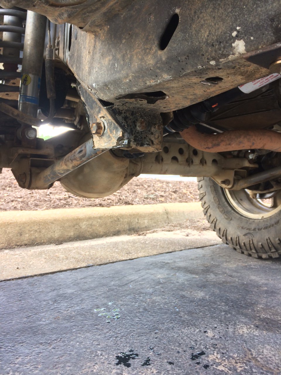

What ever happened with your oil blowing issue? I have the same problem now.

I ended up putting the breather as high as I could on the inspection cover. Put the hose as high up as I could and added a catch can. I assume yours is flipped too? I also added a bit of ATF to try and calm down any foaming, but I don’t really have evidence it actually worked.
If I were brave enough I would have drilled and tapped a breather on the rear output similar to stock. All of that gear oil slinging around is bound to get inside the breather hose...
Here is a picture of where it was.
Mine is actually pretty high. I have a billet cover I made and it's vented close to the highest point. Im thinking the main problem is where we have them. The oil slings to the vent, then the escaping air just pushes it out. The tail shaft cover is probably the real fix.
