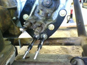

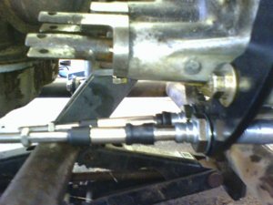

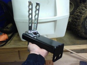

Mudpro metalworks cut me a bracket that attaches with longer bolts through the front seal housing, the cables come around from behind, havent made the attachment from the cable to the rail yet, but mud will sell you the brackets. I also had him make a box to house circle track twin sticks for a shift box. The cables can be had from surplus center. If your not afraid to fab a little, it's not very expensive.
All of it can be seen here

I looked after posting and cant findd any receipts, but I am 99% sure I ordered them from Mcmaster Carr because I remember them shipping to our warehouse, and Grainger I would have picked up.
They were the cables, adjustable mounting nuts and rod ends that I linked up with a mini clevis.
I home made ghetto shifters out of broken wrenches or some suchc.
IIRC Rich was the one who turned me on to the cables, and Lord knows as detailed as all his builds are he probably would have part #s, pictures and metallurgy analysis.

i've been on Mud's website. i didn't see the shifters (could have missed them). ..how did you get them to make the shifters to your specs?
does this set up shift easily?

They aren't on the site, if you call him and tell him you want the cable shifter brackets for a dana 300, he should know what your talkin about. The shifters themselves came from speedway motors, they have that version and a cast economy version. I'll look the part numbers up tonight.
