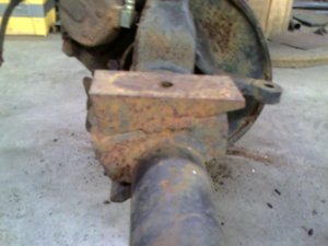

There are admittedly many different variables that come into play when DW rears it's ugly head, from worn bushings, to unbalanced tires to mis-alignment. I was pretty sure that mine was related to caster. I bought my ZJ with a 3.5" Rusty's lift on it. It was a little squirrely from the get go but it wasn't until I added some 1 3/4" coil spring spacers that the DW started.
I knew that the caster was off and that the spacers had made it worse. The cure was to fab some new front upper and lower control arms which would get the caster angle back to where it needed to be. I talked with Brandon, at Rides, and followed his recommendation to build the lowers long enough to push the front axle 1 1/2" forward. The lowers were made 17 1/2" long from eye to eye. Then I set the caster to 8 degrees and fabricated the uppers to fit, which turned out to be 16 1/4" long.
The resulting test drive a various speeds, acceleration and braking was smooth all the way, DW cured!
If you are experiencing DW on your lifted rig, check and make sure your caster angle is in the ballpark for the amount of lift you have. Every inch you lift your rig throws the caster angle further off and until that angle is addressed the DW will remain!
