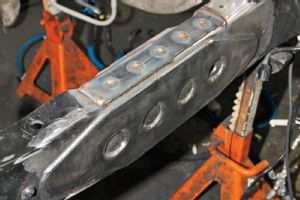

I’ve done this on a unibody I had crushed on rocks, use a hole saw and cut out a 1” hole find an curved crowbar or any type of heavy metal and work around the circle until the frames back out in place then weld ya hole back up with the hole saw piece you cut out and ya done!
If It’s on the inside of frame you’ll have to cut the hole in bottom of frame or opposite side then use a piece of metal stock and a BFH... basically with hole saw you can fix it if ya have a hammer and let bar or beater bar!

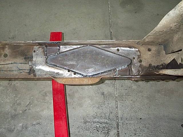

If ya don’t care about the plate appearance which if used off-road eventually you won’t, I’d plate it! I had a unibody on my rig so plates weren’t in my arsenal of tools and skill at the time lol
gives more surface area for welding, also keep the heat from a straight vertical line.
Yeah your answer is an actual answer... I gave him a visual reference and didn’t explain why lol good look out!
