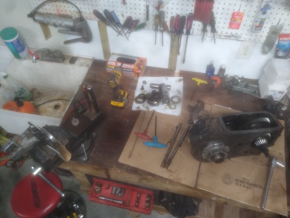

Took the stock shifter parts off last night and I can definitely get 4lo only with the right sequence as mentioned above. Other internet searching suggest that twin stick d300's are prone to popping out of gear on deceleration unless detent springs are shimmed to get more pressure. So I'm begrudgingly going to take this thing apart and shim the springs before I put it back in... Otherwise this would be a 30 minute job.
Yup...
And... I lost my marbles. Er one of the detent balls went into orbit somewhere in my garage. Just ordered 4 more... You know just in case...
Got my marbles together. Rear shift rail ridges had some wear and dents that made it hard to shift, so some light grinding and it was good.
I put two number 6 washers in the shallow hole and a smaller ball bearing in the deep hole. Deep hole is the rear and is stiffer but than the front but I'm good with it so long as it doesn't pop out of gear.
Will post pics later when I get it all together
