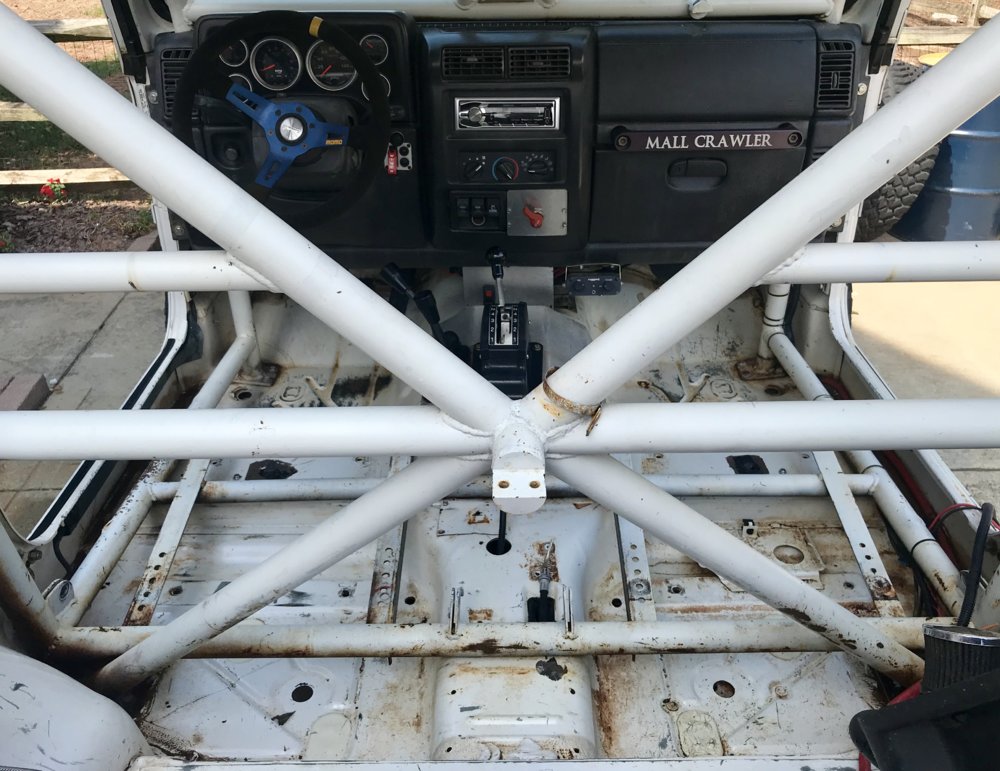

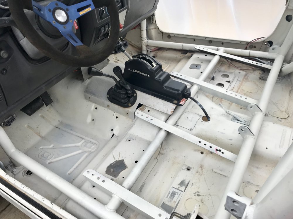

Does it make a difference? I’ve drilled a hundred holes in my tub over the last 15 years as my Jeep has evolved, just curious if it’s worth $130 or so and a few hours of work to cover the entire floor board with it.
I have the race jeep all apart for some interior upgrades (and a repaint) and thought I would line it with some dynomat while it was easy to access.
Looking to hear some exeperiences!

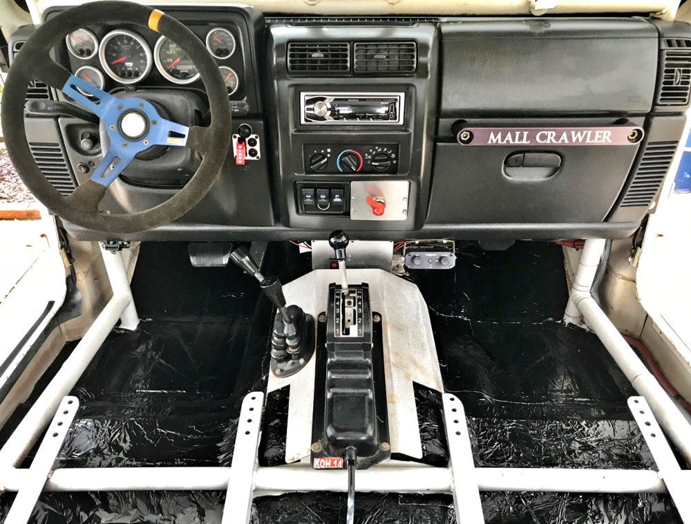

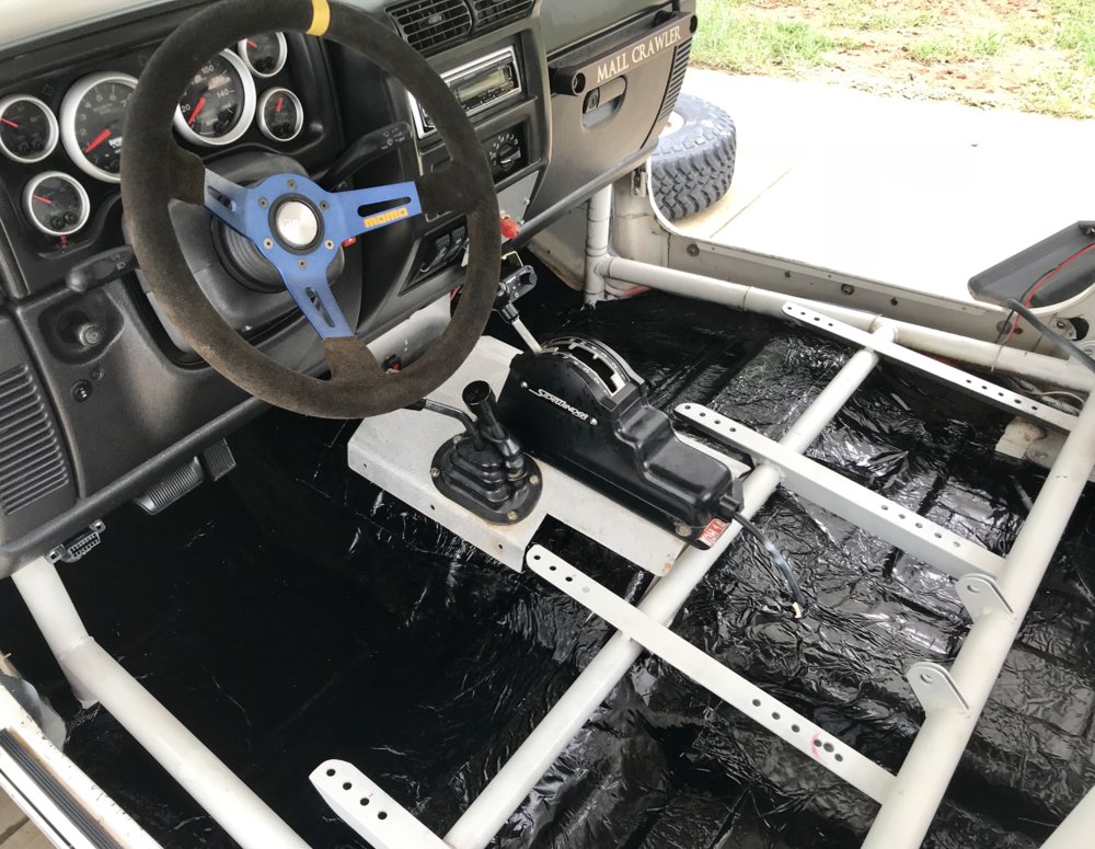

Update on the progress: HushMat is thinner than Dynomat, but it was great to work with. In the middle of a massive interior renovation for the race jeep, so I haven’t driven it yet to check road noise and vibration dampening. I’ll throw some Quadratec floor mats up front next week.
