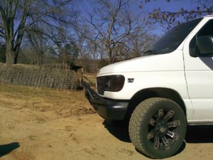

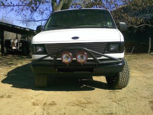

finish bumper pics.
getting closer on all the parts I can nail down, be making calls to venders hopefully nerxt week.
Thats cool stuff, we're going to put coilovers on one in a couple months. I look forward to seeing the swap and the direction you go.
