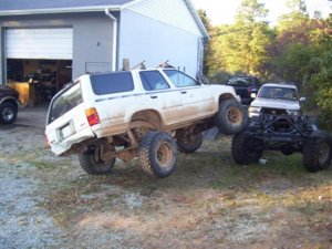

90 4runner 3.0 complete w/ rod knock but will not give up.
FJ-80 Coils in the rear, balljoint spacers in the front
Took her down to URE a few weekends ago, Open, Open, 4.10's, burnt clutch. performed decently. Clutch hindered her.
Pulled her in last night, she got a chineese clutch, Spool rear and solid spacer. Welded front, wired up the poor man's ARB. Axle disconnect is wired to switch so it can still be 3 wheel drive in 4wd, flick the switch and shes locked, locked.
Shell Climb till she rolls over which we attempted.
Shell get SAS'd eventually but debating 1 tons, and the IFS has to break first. Should happen this weekend well be at URE on SAT. abusing her.
Budget:
4runner- $100
Balljoint spacers OME Shocks- $65
FJ80 Coils Free- Thanks- Blkvoodoo
Rod and main bearings- $50
Clutch- $110
Spool- $125
Solid Spacer-$25
Bald 33's Free
All in all under $500 and shes a wheeler, answer to the ultimate budget wheeler.
You guys need to buy more parts so i can put some bling parts on it.
