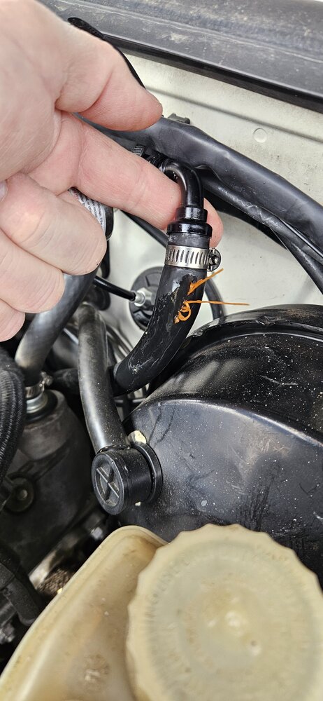

So, you guys know I've just started driving my ls swap Volvo. I'm guessing it's been driven a total of 100 miles since I first started it. I smelled heavy gas this morning after a drive with a new tune. Pic tells the story. I'm really glad I didn't have a fire with it being over the header.
I didn't expect the fuel line to be anything special, coming from amazon. But, evil energy seems to be pretty popular for that stuff. Now to figure out the next thing to do. What have you guys had success with that's easy to plumb? Time to not skimp.
This is the kit i bought. Now I see the same issue in the reviews.

Damn, that’s a heavy duty fuel pump pushing 1305 psi😲
