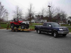

I am anxious, ready for it to be done...now I just need to clean up the Grand Cherokee and get it sold! Oh yeah a shot of BUG loaded up and ready to go to URE opening weekend! I am going to get some axle straps and different straps tonight for the trip to Windrock.
Sam...too many cars...Hinton
