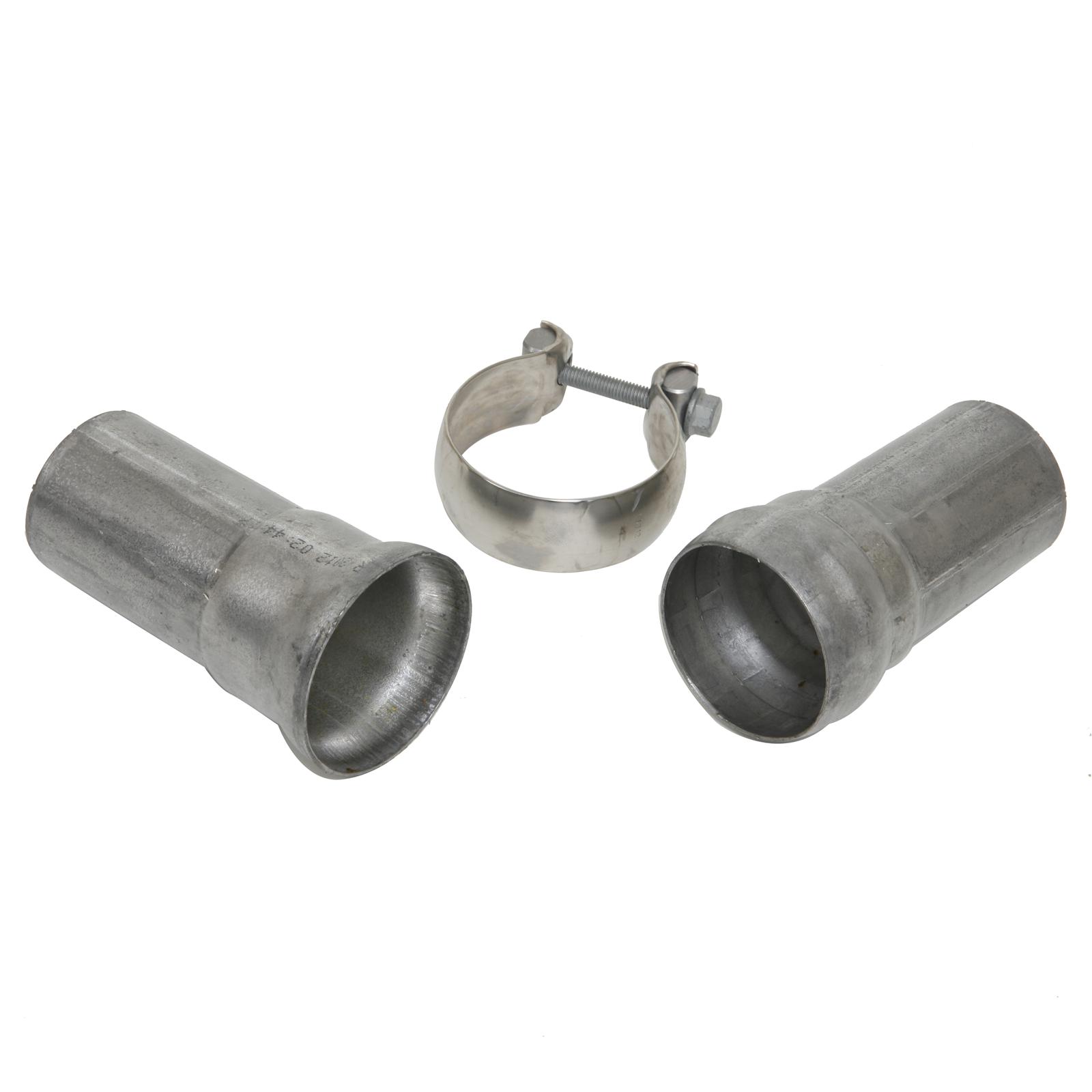

Do you plan on having to remove it? I had to cut an almost new exhaust off my 55 Chevy when I put a TKO transmission in it. I had flanges at the headers but the rest was solid. When I had exhaust put back on it the muffler man put stainless V band clamps at the headers and right at the mufflers. Now I can drop the front section and X pipe out. It cost a little more upfront but saved me a lot of headache last winter when I had to replace the throw out bearing.
Yep no way i'd fab one in a straight shot. Plan on some flanges or break points. Don't do slip fits either. The seem collects moisture from heat cycles and might as well be welded in a few years.

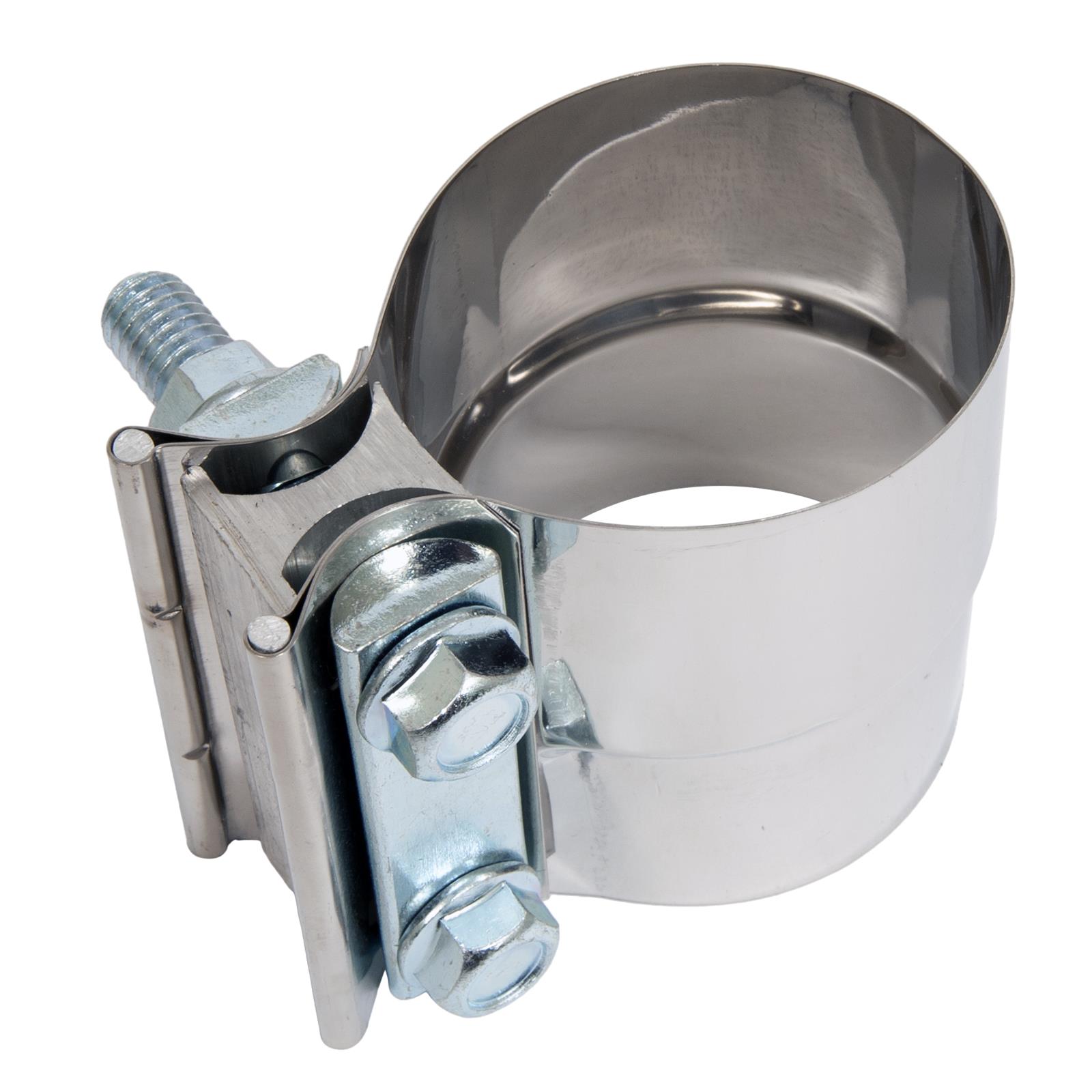

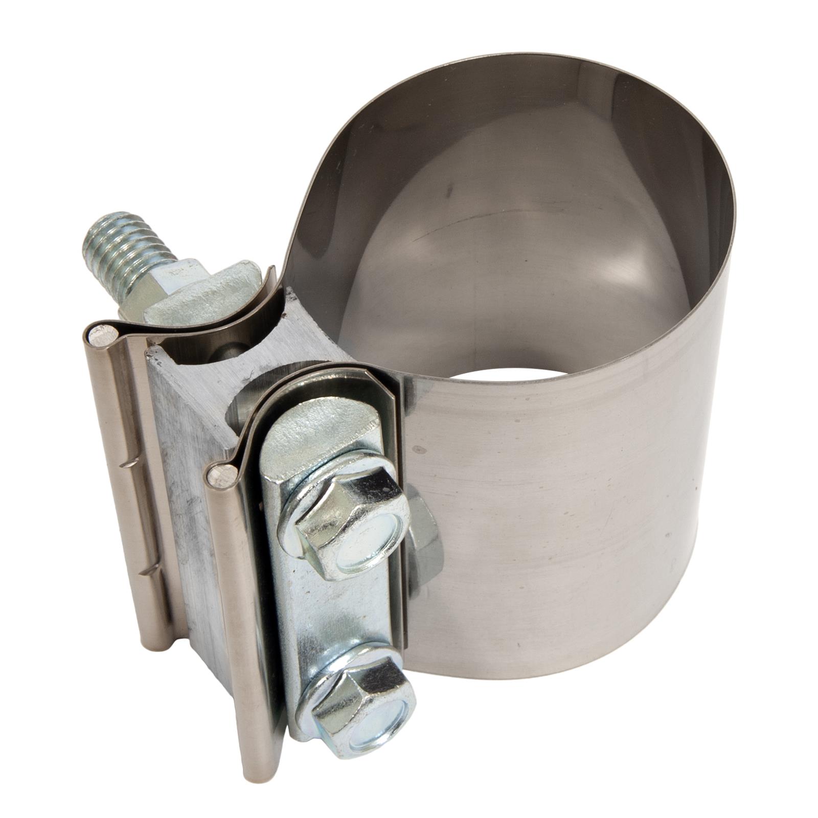

Stainless band clamps are amazing. They make them for butt connections or slip fits. They're reusable, quick, simple, pretty cheap, and seal up really well. V bands are really nice, but have to be more of a precise fit. These give a little more leeway. I'd probably weld up the tailpipe section and make two cuts somewhere further up so you can drop a section out and leave the flange bolted together at the manifold/header.
Free Shipping - Summit Racing™ Butt-Joint Band Clamps with qualifying orders of $109. Shop Exhaust Clamps at Summit Racing.
www.summitracing.com
Some of the butt joint ones have another piece of the band that slides under the other so it fully surrounds the pipe to eliminate any gaps or leaks. Either way, I love band clamps and will use them on all exhaust related work.
I’m a fan of clamps. After working on my old fox body, being able to remove and reinstall the exhaust to get to stuff was a time and money saver fo sho. If it wasn’t in the way of anything crucial I might weld it, but the fox was tight underneath. Starter was the main thing.
Those are sweet too. I have them on my gray silverado.

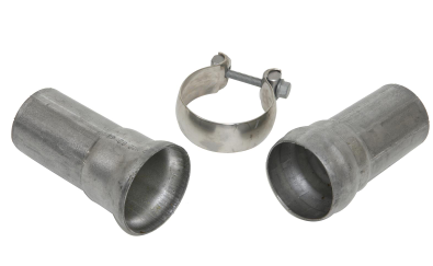

I cut the collectors off the headers and welded the ball end on them. They sealed up great the first time, not quite as well the second time, but I still like them!
