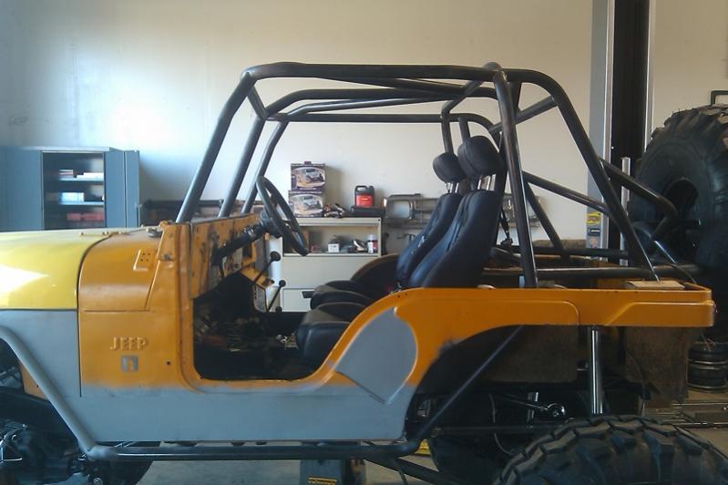

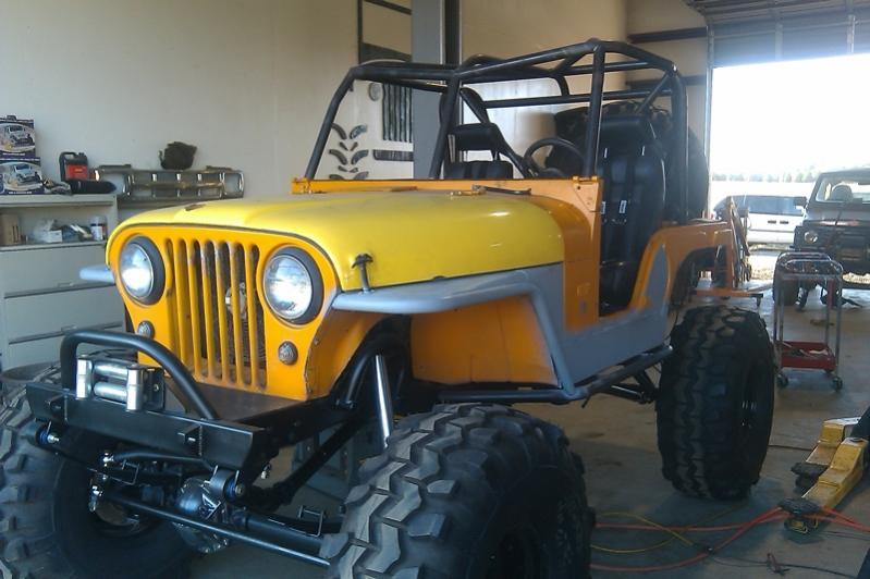

Thanks for the kind words guys. I would be more than willing to build another cage like mine or change it up some. Its a full interior cage from the "B" pillar back with exo front end and roof sliders. Since this build, i've added some tube inside the cargo area to surround my fuel tank since its now lifted up through the floor and the rear bumper is different now. Here are a few shots.
I see you have harnesses on your seats. Are those the stock seats with slots added? What belts are you using?
Yes, stock seats. I took the covers/pads off and cut out the metal in the seat frame, put foam back on and cut it out/sleeved the hole with rubber from tire inner tube, cut slits in seat covers and stiched them up and reinstalled. The harnesses are just cheap ebay ones that will eventually be replaced for something nicer.
