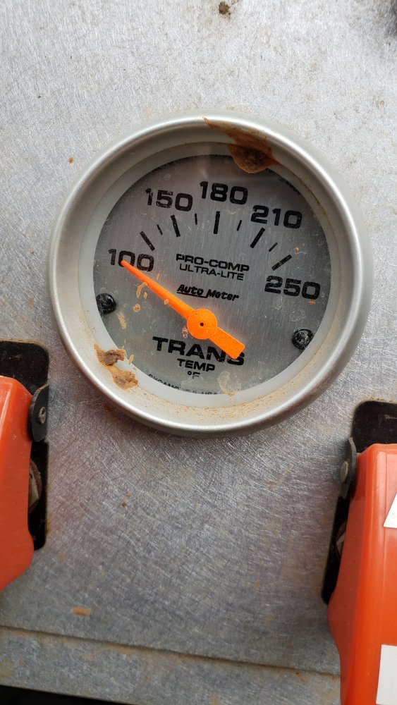

The trans temp gauge in the CJ stopped working. How can I check to make sure the gauge isn't bad? Thought about switching the engine temp wire to it to see if it goes up any.
Same. Ground the wire that goes from the sender to the guage. Just make sure the key is on. Full ground = full hot.
